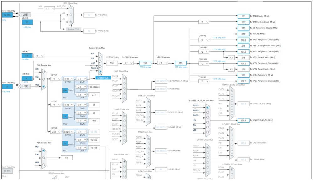

Hi ASCha.3 again,
I could finally write on an sd card.
The first problem was the sd card. I tried another Sandisk class10 and it worked.

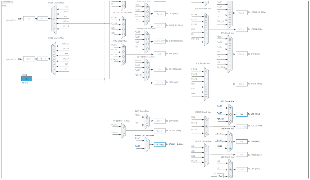

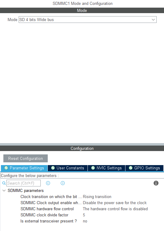

But I have some issues with clock settings, I couldn't understand why it is happening.
If I use below 5 clock dive factor, I get "f_mount(1)" error. If there is no sd card connected, it gives "f_mount(3)" error.
I changed the clock settings, but it doesn't affect the clock divider factor. I mean at a lower frequency if I choose less than 5 it gives an error.
The working clock settings is at the below pictures ( With 5 divide factor it is not possible to get 50Mhz)
Do you have any idea why I can't use the below 5 divide factor?

cpu setting:

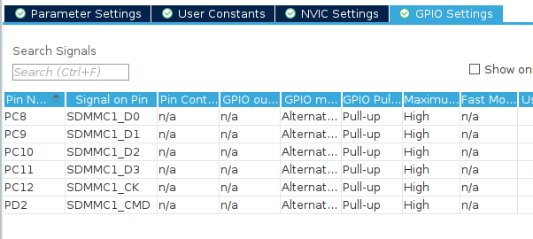

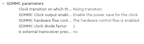

0693W00000aJkM0QAK.png0693W00000aJkMKQA0.png0693W00000aJkMeQAK.png0693W00000aJkLJQA0.pngif port/pin speed to high, may get strong reflections - card not working !
if pin-speed to low, can work only with low speed on transfer.
My settings are the same as yours. When I changed the max pin speed from very high to high it worked in 1 clock divider factor and 100MHz PLL2R. I am using PLL2R because if I want to use PLL1, it decreases CPU Mhz for 100MHz SDMMC and it causes mount error. After trying a new clock setting it stopped working, I changed back to the same settings but it doesn't work again with 1 clock divider factor. If I make it 5, then it works.

I guess I should find a new sd card that works or I should use 5 clock divide factor with 183MHz.

using PLL1 or 2 is not important, just the clk value .
Unfortunately, I can't make it work at 100MHz dv1 again. But, it works at 100Mhz div2 with "high" max pin speed.

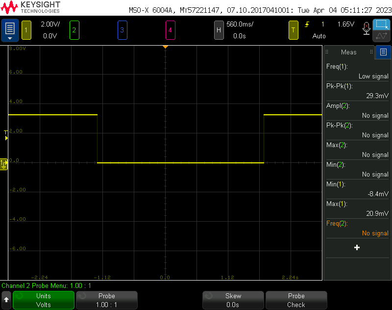

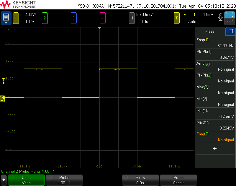

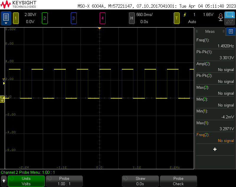

Hello AScha
SDMMC is working at around 32MHz. I made some tests and got distorted results. To see on an oscilloscope if the writing speed is fast enough I am toggling pins at the very beginning of full callback and the end of the writing process. But I realized a problem, sampling speed is too slow when I use fatfs writing commands. What might be the problem?
The first pic is from full callback without fatfs write cmds(below).
/* USER CODE BEGIN 4 */
void HAL_ADC_ConvHalfCpltCallback(ADC_HandleTypeDef* hadc) {
		for (int i = 0; i < ADC_BUF_LEN/2; i++) {
		fres = f_printf(&fil, "%d\n", adc_buf[i]);
void HAL_ADC_ConvCpltCallback(ADC_HandleTypeDef* hadc) {
	HAL_GPIO_TogglePin(GPIOB, GPIO_PIN_11);
	for (int i = ADC_BUF_LEN/2; i < ADC_BUF_LEN; i++) {
	if(HAL_GPIO_ReadPin(B1_GPIO_Port, B1_Pin)==GPIO_PIN_SET){  //Check if button pressed
			      f_close(&fil);
			      f_mount(NULL, "", 0);
			      myprintf("closed\r\n");
/* USER CODE END 4 */
The second pic is with fatfs write cmds.
Another problem is it gets much slower if f_close is not done yet.
AScha.3
f_print...you have text ???
you have 16bit data - so write in callback the whole block -> f_write(...) .
