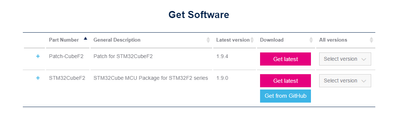

Hello @SDu T ,
For the import project issue. I made some tests and I can't reproduce the issue.
For that, could you please try to download the STM32CubeF2 from this link
Then, to import the project in STM32CubeIDE1.14.0 version, I recommend you to follow these steps:

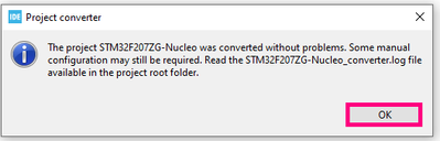

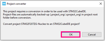

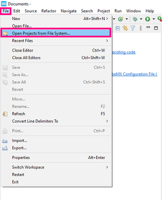

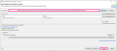

1- Open STM32CubeIDE1.14.0 version
2- Click File-->Open Projects from File System as shown in the below figure
3- Browse the Demonstrations\STM32CubeIDE project file located in this path "\STM32Cube_FW_F2_V1.9.4\Projects\NUCLEO-F207ZG\Examples_MIX\UART\UART_HyperTerminal_IT\SW4STM32\STM32F207ZG-Nucleo" as shown in the below figure
4-Click on OK to import convert the project
5- Build the project
