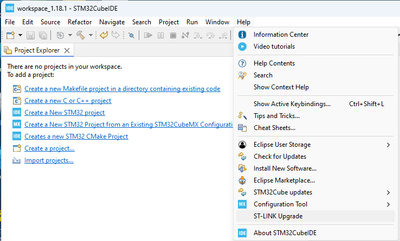

I am working with the EVSPIN32G06Q1S3 and the STLINK-V3SET, I have the two programmer/debugger boards mounted on top of each other. Then I have the UART connector connected to the EVSPIN32G06Q1S3 (J5) and the programmer/debugger boards (CN7). I have 230 VAC going into the EVSPIN board. The lights on both the STLINK and the EVSPIN turned on. Device manager recognizes the LINK, but I can't detect the EVSPIN in Motor Pilot or STM32CubeIDE. I've tried the "Discover Board" option in Motor pilot and manually changing the baud rate to each option with no results. I think it might be a firmware issue, but I'm not entirely sure.

Hello @Hugo_,
With STM32CubeIDE tool, you can try to upgrade the ST-LINK version:
If you agree with the answer, please accept it by clicking on 'Accept as solution'.
