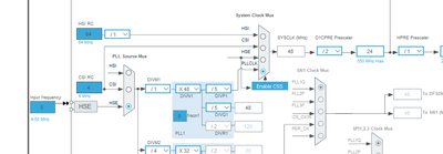

Based on the documentation, I have configured the FDCAN1 interface to use PD0 (FDCAN1_RX) and PD1 (FDCAN1_TX). The FDCAN peripheral clock is set to 20 MHz. The external transceiver is correctly connected and powered, and the rest of the board appears to function normally.

No. You need to use 5MHz as Input frequency as I shared in the ioc file I've attached previously. You don't have any 24MHz source on the board. If you need your system clock set to 24MHz with a 5MHz as HSE input, this is the right configuration:
And you need to check if the STLINK-MCO is set to output 5MHz as stated in the article: How to use STLINK-V3 MCO output on Nucleo boards as a precise clock source for STM32

NUCLEO-H723ZG is not available as example on the article (Github hotspot link) only NUCLEO-H753ZI is supported. But you can easily port the example from STM32H753 to STM32H723. The example is already using PD0 and PD1 GPIOs + STLINKV3-MCO output as clock source for the system clock. Refer also to this article: How to use STLINK-V3 MCO output on Nucleo boards as a precise clock source for STM32

- To port I found one issue with the DIVN1/2/3 - minimum I can go upto x4 but in the example it is mentioned to have x1. - Attachemnt provided

- I have gone through the 2 articles and I reverted my clock to 5mhz.
