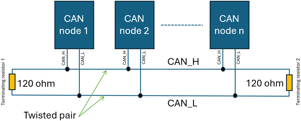

Are you sure this is the only hardware you are using?
Where is the CAN transceiver? where is the second node that needs to be connected to the CAN bus? where are the terminating resistors?
And this is what you need as a minimal hardware to establish a successful CAN communication in Normal mode. You need at least two CAN nodes connected together. This is what you need for CAN communication in Normal mode:
This is already explained in the section 3. Hardware setup in the mentioned article. The two nodes should have the same CAN bitrate and you must use an external accurate clock source (example: Crystal). HSI and other internal clock sources are not recommended for CAN operation in Normal mode.
CAN is not SPI or UART to probe the Tx with only one device. You need at least two CAN nodes to ensure the successful operation of the acknowledgement mechanism.
Or simply use External Loopback mode and probe the CAN_Tx pin. In that case you are not obliged to use a second CAN node.
mani9989
WIth the terminator resistor it works. I can now see the Transmission.
But I dont see the reception. I am sending the can frame and dont get the inteerupt hit. ANy idea what can be the problem.

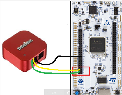

Please be more specific and provide more details. We cannot help you if you don't share enough information with us:
1 - Please provide a clear sketch of the complete CAN bus: the two nodes + their transceivers + the two terminating resistors.
2 - Share your project, a minimal but with a complete software that can be run from our side.
Without the requested information, I cannot help you further.
Thank you for your understanding.

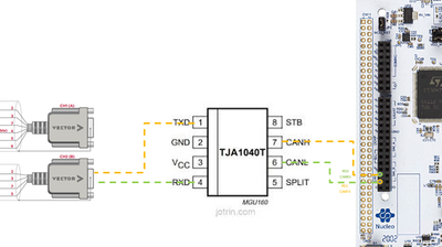

Hello @mƎALLEm ,
I have attached the HW sketch and the IOC file.
Can you please let me know if the clock settings are right.
I am looking for can clock 8Mhhz
BR
Mani
Are you sure this is the hardware you've adopted?
Tx/Rx transceiver side need to be connected to the STM32, while CAN_H and CAN_L need to be connected to the "CANoe"
That looks entirely backward.
The CAN_H / CAN_L are the **BUS** side of the interface, the TX/RX is the STM32 side.
CAN_High to CAN_H
CAN_Low to CAN_L
GND to GND, ie common, like to the chassis of the vehicle.
mani9989
hello @mƎALLEm
Yes you  are coorect. So you go the picture of the setup.
CAn you check ioc for the clock config where I am looking for can clk with 8Mhz and Input Freq 24Mhz
