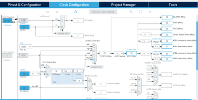

Hi All , On trying PWM signal generation using STM32 L073RZ board, I could only maximum get the PWM signal frequency of 580 Khz , why is it so? Because  all the timers and system clock frequency was set as 32 MHz and PSC =  0 and Period : 2 , I should supposed to get 16 MHz PWM signal correct? why I cannot achieve this? Please guide me.
A) you have wrong clock configuration
B) you have wrong timer configuration
Use MCO feature and PLL instead of Timer. It will have better frequency resolution.
Hi , Please find below the clock configuration , I have used TIM2_CH1 for generating PWM signal @ PA0 pin. All timers are configured to 32 MHz only, In my clock configuration , the MCO source is not selectable ( greyed out). And the below code is what I used for the same. Please guide me  how to get the desired frequency of PWM signal( atleast 16 MHz) . FYI, I am using STM32 L073RZ board.
The value of htim2.Init.Period was changed many times and at max I have got only 580 Khz signal by setting this value as "55-1".

Search tutorials to use MCO ... for example:
https://community.st.com/t5/missing-articles/how-can-i-output-a-clock-signal-to-the-stm32-s-mco-pin/td-p/49583
If your timer "period" is set to 55, then its frequency will be 32MHz/55=582kHz... what is wrong with that ? :)
Looks like you need to study the basics. Take a look on series of STM32 MOOC courses
https://www.youtube.com/watch?v=sQCqVBuq-gA&list=PLnMKNibPkDnGtuIl5v0CvC81Am7SKpj02
and STM32 "hands on" courses (youtube). You can also search for some books. For example "Mastering the STM32 Microcontroller by Carmine Noviello" is good one. Also you can find good tutorials on web. for example:
https://embedded.fm/blog/embedded-wednesdays

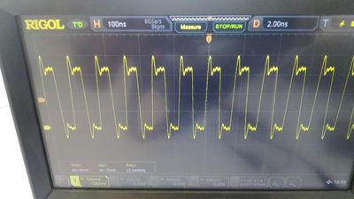

Thanks for pointing out , using RCC and MCO and I could generate 12 MHz clock signal ( square pulse) , but it is ringing like below , kindly guide me where I am doing wrong ( or) the exact output from the MCO will be like this.
Below is the system clock configuration.
* The system Clock is configured as follows :
* System Clock source = PLL (HSI)
* SYSCLK(Hz) = 12000000
* HCLK(Hz) = 12000000
* AHB Prescaler = 1
* APB1 Prescaler = 4
* APB2 Prescaler = 2
* HSI Frequency(Hz) = 16000000
* PLL_MUL = 6
* PLL_DIV = 2
* Flash Latency(WS) = 1
* @retval None
Wrong probing, probably like in figure 1.9 there:
https://download.tek.com/document/02_ABCs-of-Probes-Primer.pdf
