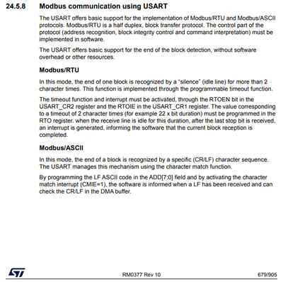

We know that Modbus-RTU is a UART link, but we found that some MCUs(For example:STM32L031K6) supporting Modbus have 2 register-bits for the Modbus mode. They are RTOEN and RTOIE. Refer to the Reference Manual, these 2 bits need to be set to activate. But we couldn't find the same register-bit in STM32F030's document.
Can we achieve the function by software without the register-bit? Are there some knowhow documents about this issue?
Thank you and best regards!

MCU support on the micro sounds like a 'nice to have’. I have implemented Modbus RTU on countless microprocessors (that have a UART of course). If the MCU doesn’t support a settable RX timeout ISR you can implement one with a hardware timer. Receive one char at a time and wait to see if there is a timeout before the next. Getting the timing for the timeout correct is a little tricky (based on baud rate) but it is all in the specification. The baud rates are magnitudes higher now then when Modbus was first implemented, so the criticality of the timeout framing has been less of a factor for us.

@PacteraHW2018 Note that all replies are public - everyone can see everything - so there's no need to repeat stuff in multiple replies.
@PacteraHW2018 wrote:We found that some MCUs(For example:STM32L031K6) supporting Modbus have 2 register-bits for the Modbus mode. They are RTOEN and RTOIE. Refer to the Reference Manual
Indeed:
But, as @jlag said, that's just a "nicety" - nothing that you couldn't also achieve using other standard means.
