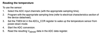

Did you :
run ADC calibration first ?
HAL_ADCEx_Calibration_Start(&hadc1, ADC_SINGLE_ENDED);
then :
>nowhere I found a formulae explaining the influence of the conversion scale neither the influence of Vref.
Vref is 3v3 ; if your VDDA=VREF is different, it just scales linear, no hidden secrets here ;
then see:
>we extend the sampling time to comply with the minimum 9 µs.
ok, set TSEN, but then wait a little ( HAL_Delay(15); ) , before reading the ADC->temp input.

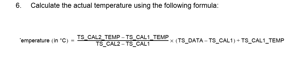

May i ask where did you get the TS_CAL2_TEMP - TS_CAL1_TEMP from?
I know how to get TS_CAL2 and TS_CAL1 but how do you get TS_CAL2_TEMP and TS_CAL1_TEMP what do those stand for?

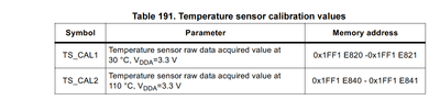

2024-07-24 1:51 AM
Sure... :)
see ds:
here TEMP -> 30° and 110° given , where the CAL values are related to .
2024-07-24 1:52 AM
aha so (130 degrees - 30 degrees) / (TS_CAL2 - TS_CAL1) will do it.
2024-07-24 2:01 AM
110° - 30° .... :)
2024-07-24 2:03 AM

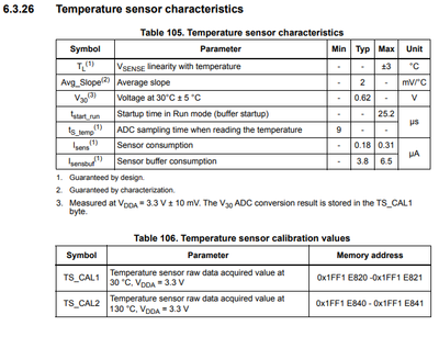

I'm using the stm32h747 so the values are bit differend i think.
2024-07-24 2:15 AM
On H747 ... 130 - 30° , your right.
Or misspelled (i assume) , because:
So how/why should they give a reference value at a temperature - thats nor allowed for the chip ???
+ On all others (H743, H750, H7A3 ..) 110° + 30° are given.
