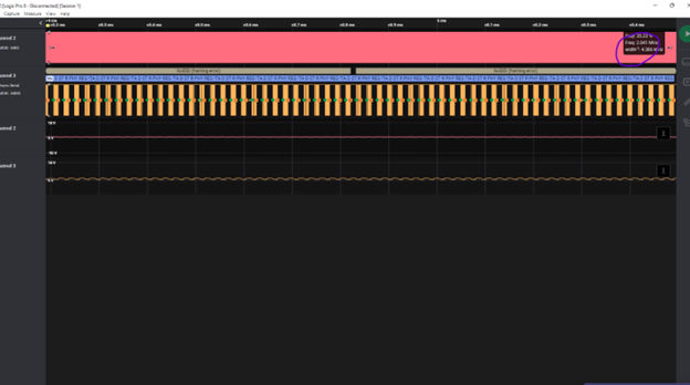

Thank you for replying to my team mate's question. Here is the code for MDIO write and read. The MCU we are using is STM32L552MEY6

Just thinking about FPGA to do this more efficiently. Just trying to understand when to make that pivot? The board contains one MCU pinging 5 PHY chipsets and reporting data over serial protocol to a GUI.

Looking at your code, I see frequent calls to HAL_GPIO_WritePin()
Remember that's a function, for which you'll have a function-call and all the processor-overheads that it involves.
The fastest way to set a bit in a port is by writing directly to GPIOx->BSRR
To set bit 0 in GPIOB you would do
GPIOB->BSRR = 1;
And to clear that bit you would do
GPIOB->BSRR = 0x10000;
To get a better understanding of what's going on here, I strongly recommend that you read chapter on General Purpose I/Os (GPIO) in the Reference Manual for your stm32. You could also look at the source code for HAL_GPIO_WritePin(), which might be something like (here it is from stm32l4xx_hal_gpio.c)

Depending whether you are in Debug or Release builds, and what optimisations you selected, the asserts might be ignored altogether, but you are still wasting processor-cycles by having a function-call and an if-statement.

Replace the body of your loop with:
GPIOB->BSRR = data & 0x80000000 ? GPIO_PIN_4 : GPIO_PIN_4 << 16;
data <<= 1;

Hello Danish,
Thanks for your reply, yes have been into looking the reference manual of our particular board and thereby "SET" the BSRR reg and got pull down frequency from 2.6Mhz to 250 Hz. I know it should increase as you said earlier (by eliminating the function call for HAL_WRITE_PIN). Kindly share your thoughts on these anomalies!
Code:
while (1)
GPIOB->BSRR = (uint32_t) GPIO_PIN_6;
GPIOB->BSRR = (uint32_t) GPIO_PIN_6 << 16U;
Note: Just trying to toggle the GPIO pin 6 and then if it meets our requirements can implement the same in MDIO fun calls !!
