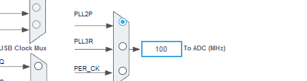

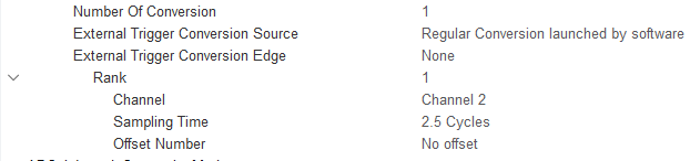

>How do you configure sampling rate in CubeMX?
  1. see clock configuration -> clk to ADC (i took about 100 MHz)
  2. in ADC parameter settings -> clock prescaler + (for selected rank + channel) sampling time
Alexmouse
AlexmouseAuthor
January 10, 2023
It is the STM32H745 Discovery board, 25MHz crystal, clock configurator reports 30MHz ADC clock.
I've Timer17 toggling an led at 1Hz, 75MHz clock, prescale 749, count of 50,000, this works as expected.
I'm not seeing sampling times in CubeMX, only clocking options in binary steps?
AScha.3
January 10, 2023
(i am on H743 , single core ; maybe you have to select core M4 or/and M7 )
but nothing should be red color !! this will not work the "right" way.
in clock tree
0693W00000Y7rKdQAJ.png+
0693W00000Y7rMjQAJ.png+
try.
Alexmouse
AlexmouseAuthor
January 10, 2023
Ah thanks, now I see the sampling settings!
