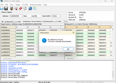

    • We also checked for flash corruption. When we read the Flash (Device memory) and save the file and compare the saved file with the original binary, there are no differences. So, this proves that there is no corruption in flash.

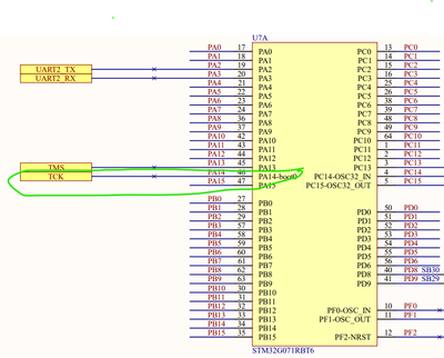

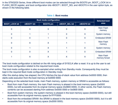

As we mentioned before, we do not use any pull-down resistor in this circuit. For this series of MCUs, there are three options for BOOT configuration:
  1. BOOT0 pin
  2. BOOT_LOCK bit in the FLASH_SECR register
  3. Boot configuration bits nBOOT1, BOOT_SEL, and nBOOT0 in the user option byte
We use the third option.
Additionally, for your information, we use the similar MCU in other projects without any external pull-down resistors and have never encountered any issues.
For this faulty PCB, I attempted to place a pull-down resistor to observe any effect. However, after connecting a pull-down resistor to Pin 25 (PA14), nothing changed—the MCU still freezes and does not operate!
I already checked the Device Errata and no similar issue found.

And as mentioned before, BOOT0 should always, always, always be pulled down (10K is fine) as a matter of good practice.  If you intend to use the MCU's Bootloader or RAM start then a mechanism (usually a jumper to VDD) is needed to drive BOOT0 high.
As an aside, ST didn't do anyone any favors by combining BOOT0 and a debug pin.  That was pure stupidity.

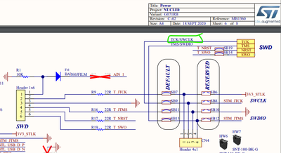

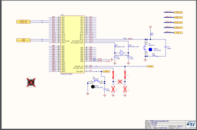

We placed a resistor temporarily to check if it would have an effect, but there is no dedicated place for such a resistor in the design.
As we mentioned earlier, we produced 1500 units and delivered them to our customer. Some of them failed after a couple of days or after a few charging cycles.
I think the discussion about the BOOT pin is irrelevant in this case. Even in the evaluation board from ST, "STM32 Nucleo-64 boards (MB1360)," does not use an external pull-down resistor on the BOOT pin. Therefore, this discussion should be concluded as it does not pertain to our issue.|

Farhadpi
This is the screenshot of the ST-Link utility after comparing the faulty PCB flash memory:
