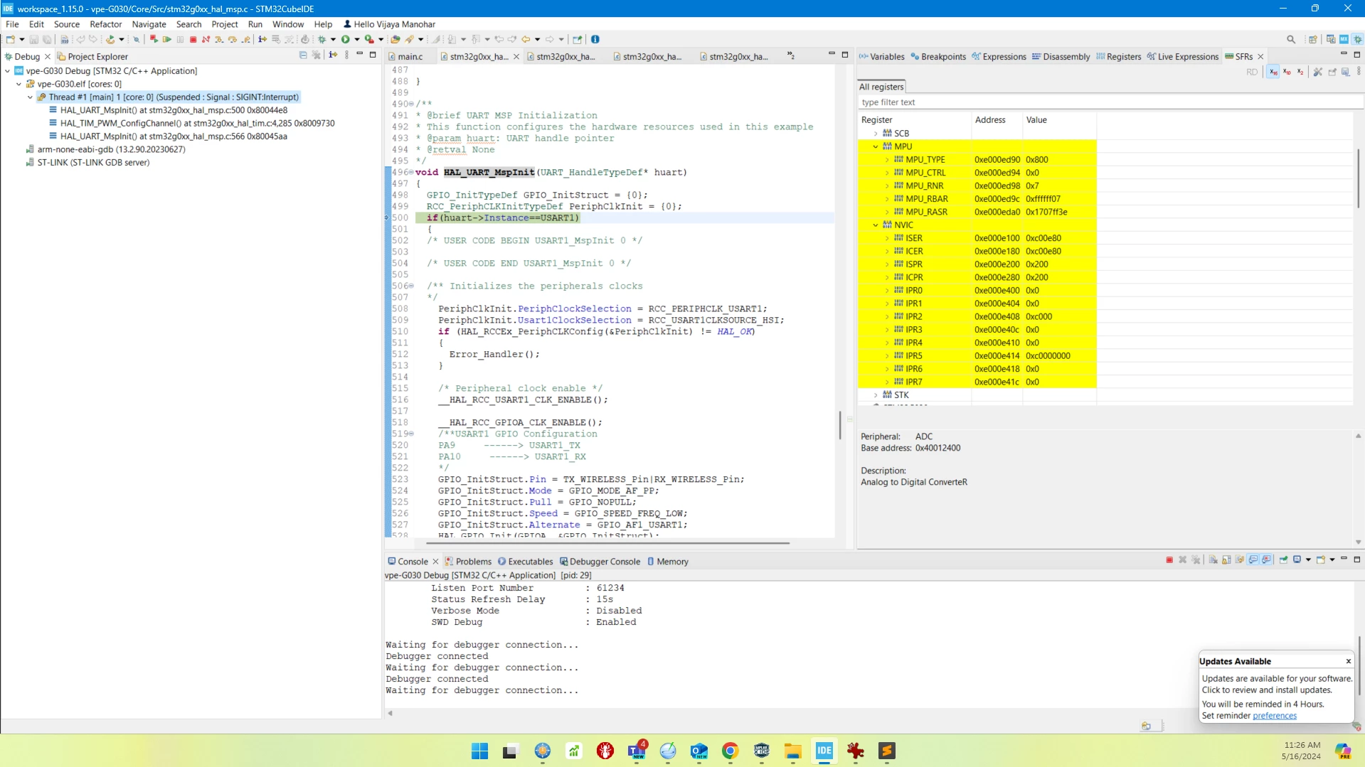

If the product is assembled it will go into a burn-in test where 70 plus products will be charged and de-charged between 3 to 10 times. During this test 1 to 3 products are failing, and with failing I mean the MCU does not advance further or freeze as shown in the below picture.
It stops at the following line of code:

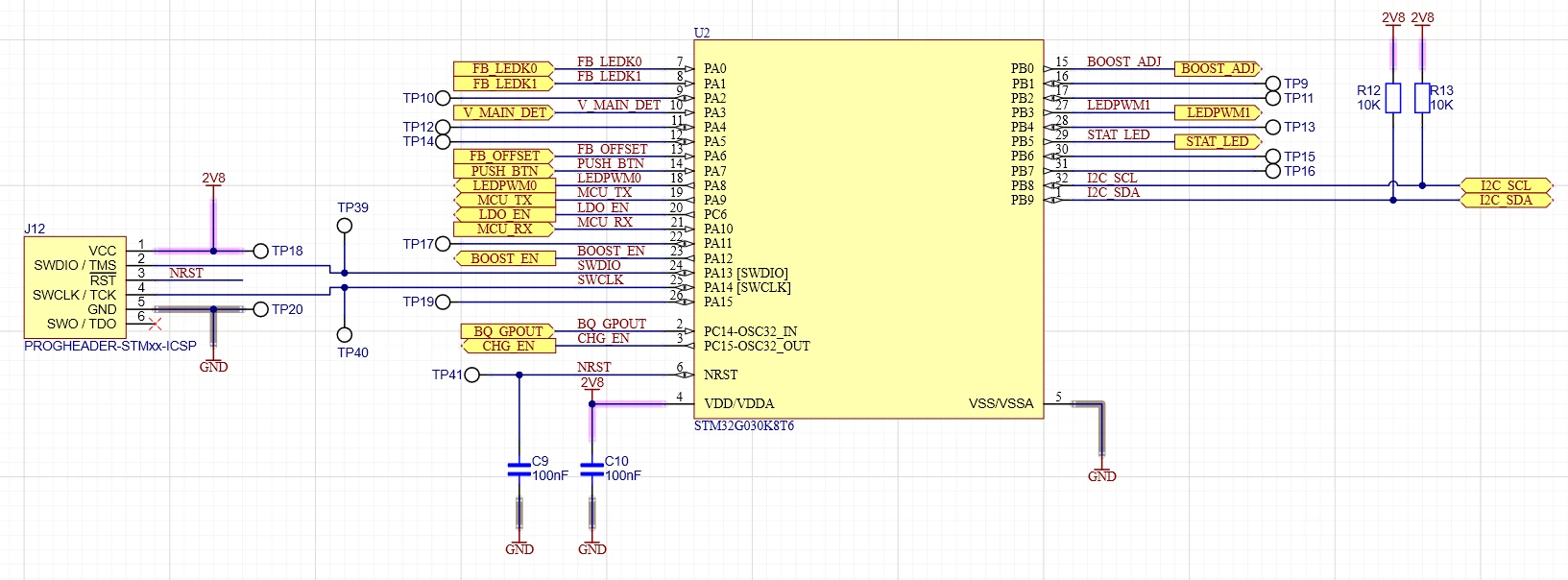

  • Below is the configuration of the HW.
    • MCU: STM32G030K8Tx
    • USB to UART Chip: CH340E
    • UART Port:  USART1

I wonder if his BOOT0 pin is left floating too?
Visitor II
May 16, 2024
Boot0 pin is left open, we use this pin for debugging/programming.
Is there any related reason for asking?
Andrew Neil
May 16, 2024
Leaving it open makes it susceptible to noise.
Have a resistor to pull it to your "normal" level - you can override that for debugging/programming

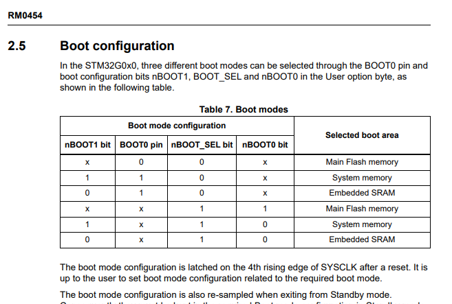

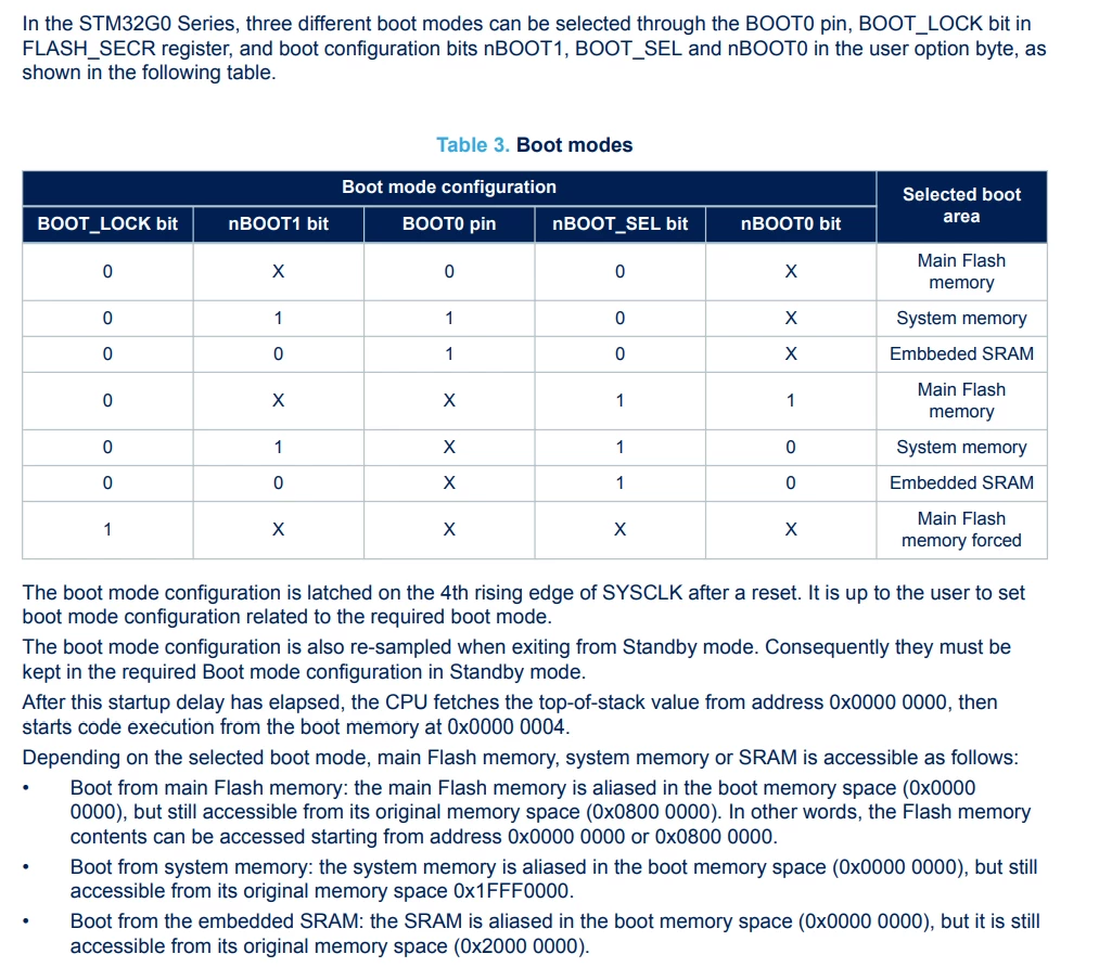

To boot from main flash (ie, run your code), you want it pulled low:
Does your application use Standby mode?
Are you working with @PLER on that same product they posted earlier?
Visitor II
May 16, 2024
Yes, we utilize Stand-by mode.
We're collaborating on the same product with @PLER.
Understood, for running the code from Flash memory, the BOOT0 pin should be low.
Considering this, there would be two questions:1. Is it possible to use the internal pull-down for the BOOT0 pin?
2. In the event that the Boot pin get noise and resulting in the MCU freezes, would a reset or re-powering typically resolve the issue? However, in our scenario, the device works after re-flashing the MCU.

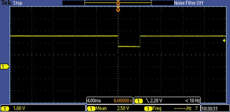

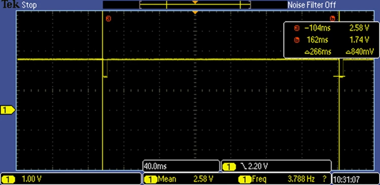

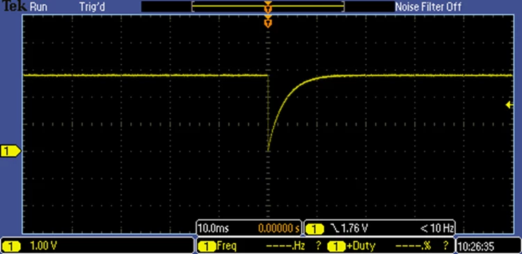

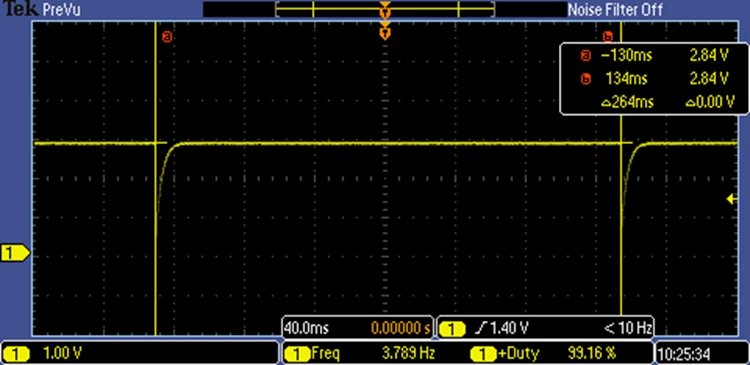

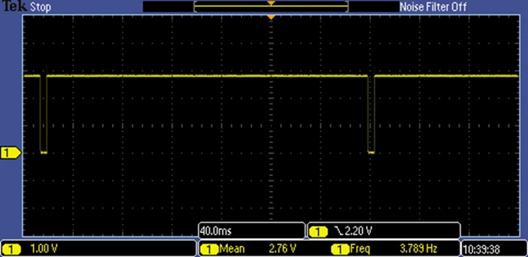

I measured some test points on the frozen MCU and observed that some pins are behaving oddly, like this:
1. NRST:
2. MCU_TX:
3. TP9/TP10
the rest of the Test Points like
TP11/12/13/14/15/16/17/19
are low.
MM..1
May 17, 2024
From this graph MCU isnt frozen but reset every 260ms. And too MCU_TX levels is ugly.
HOW is your app CLK , how is managed undervoltage protection ...
Try on frozen board connect regulated PSU over Vcc 2V8 and go up slowly ...

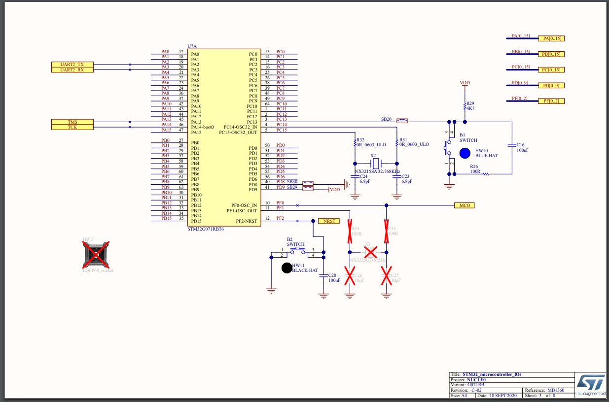

Is a pull-down resistor now installed at BOOT0?  If no, why not?
Have you evaluated the Device Errata in the context of your problem?
Visitor II
May 17, 2024

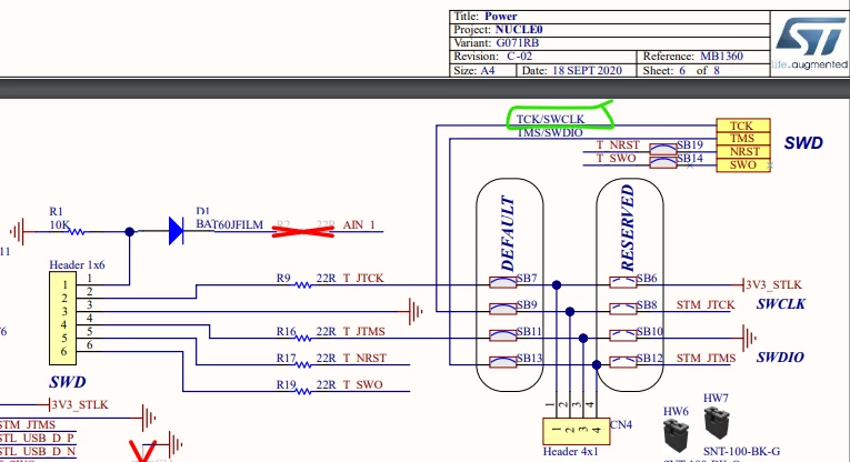

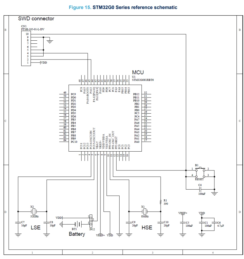

We placed a resistor temporarily to check if it would have an effect, but there is no dedicated place for such a resistor in the design.
As we mentioned earlier, we produced 1500 units and delivered them to our customer. Some of them failed after a couple of days or after a few charging cycles.
I think the discussion about the BOOT pin is irrelevant in this case. Even in the evaluation board from ST, "STM32 Nucleo-64 boards (MB1360)," does not use an external pull-down resistor on the BOOT pin. Therefore, this discussion should be concluded as it does not pertain to our issue.|

As we mentioned before, we do not use any pull-down resistor in this circuit. For this series of MCUs, there are three options for BOOT configuration:
  1. BOOT0 pin
  2. BOOT_LOCK bit in the FLASH_SECR register
  3. Boot configuration bits nBOOT1, BOOT_SEL, and nBOOT0 in the user option byte
We use the third option.

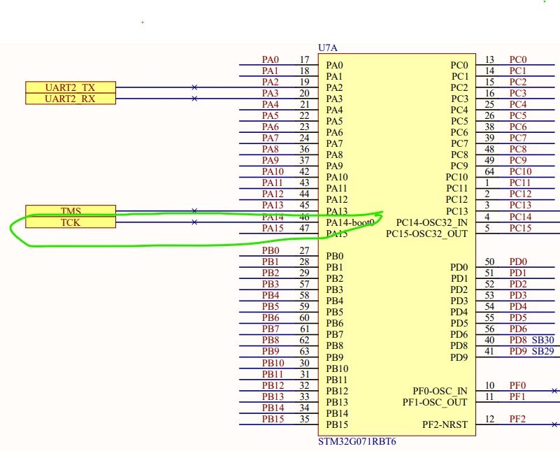

For this faulty PCB, I attempted to place a pull-down resistor to observe any effect. However, after connecting a pull-down resistor to Pin 25 (PA14), nothing changed—the MCU still freezes and does not operate!

As we mentioned before, we do not use any pull down resistor in this circuit.
Oh, according to your traces it's clearly doing something.
And as mentioned before, BOOT0 should always, always, always be pulled down (10K is fine) as a matter of good practice.  If you intend to use the MCU's Bootloader or RAM start then a mechanism (usually a jumper to VDD) is needed to drive BOOT0 high.
