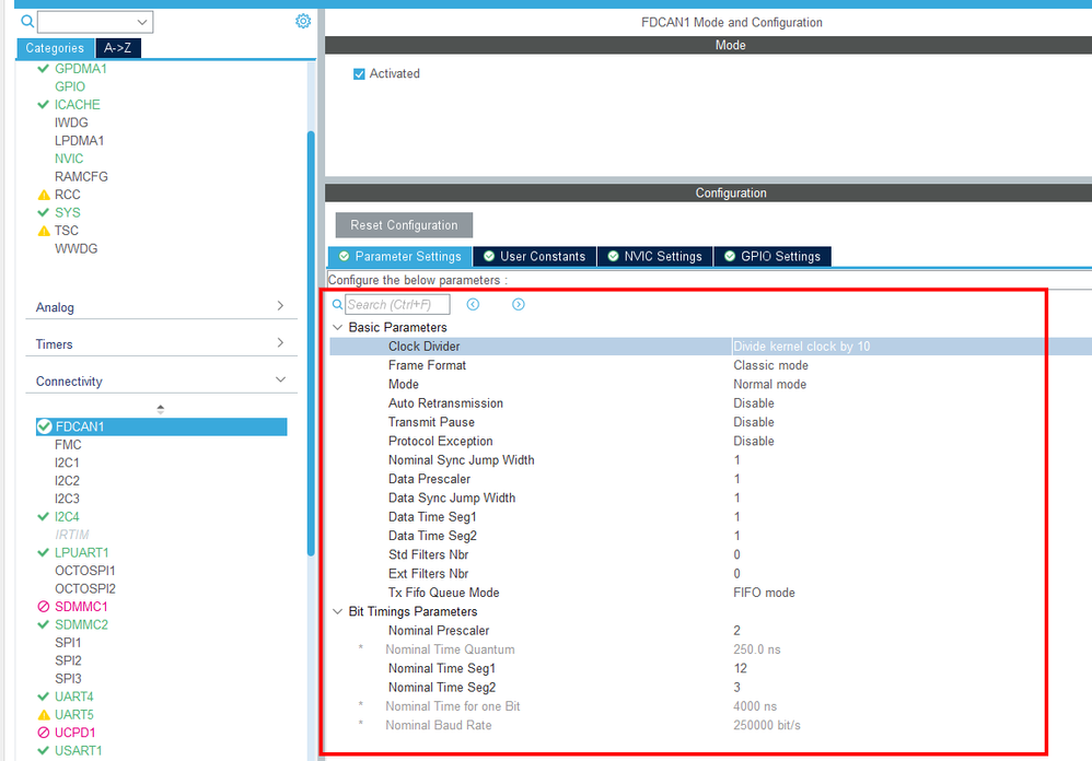

dylanou
hfdcan1.Init.Mode = FDCAN_MODE_NORMAL;   // can not work
hfdcan1.Init.Mode = FDCAN_MODE_BUS_MONITORING;   //  work well
hfdcan1.Init.Mode = FDCAN_MODE_EXTERNAL_LOOPBACK;   //  work well
  1. Are you using a transceiver with another CAN node connected to the bus?  if it's not the case it won't work.
  2. These values are not recommended for CAN bit time settings::
    hfdcan1.Init.NominalPrescaler = 32;
    hfdcan1.Init.NominalTimeSeg1 = 2;
    hfdcan1.Init.NominalTimeSeg2 = 2
    See my answer in this thread.

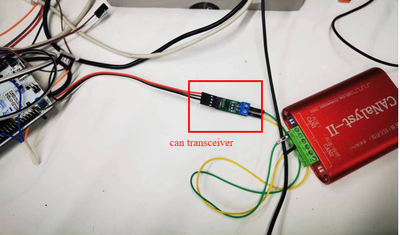

dylanou
1. had can  transceiver
dylanou
work at FDCAN_MODE_BUS_MONITORING or  FDCAN_MODE_EXTERNAL_LOOPBACK ,It can receive or send data
dylanou
dylanou
I change below,but it doesn't work too
hfdcan1.Instance = FDCAN1;
hfdcan1.Init.ClockDivider = FDCAN_CLOCK_DIV10;
hfdcan1.Init.FrameFormat = FDCAN_FRAME_CLASSIC;
hfdcan1.Init.AutoRetransmission = DISABLE;
hfdcan1.Init.TransmitPause = DISABLE;
hfdcan1.Init.ProtocolException = DISABLE;
hfdcan1.Init.NominalPrescaler = 2;
hfdcan1.Init.NominalSyncJumpWidth = 1;
hfdcan1.Init.NominalTimeSeg1 = 12;
hfdcan1.Init.NominalTimeSeg2 = 3;
hfdcan1.Init.DataPrescaler = 1;
hfdcan1.Init.DataSyncJumpWidth = 1;
hfdcan1.Init.DataTimeSeg1 = 1;
hfdcan1.Init.DataTimeSeg2 = 1;
hfdcan1.Init.StdFiltersNbr = 0;
hfdcan1.Init.ExtFiltersNbr = 0;
  1. had can transceiver -> Need to provide more details about your transceiver's module: the transceiver datasheet + module schematics as this is an important point for analysis.
  2. work at FDCAN_MODE_BUS_MONITORING or FDCAN_MODE_EXTERNAL_LOOPBACK ,It can receive or send data. -> Expected behavior if there is a HW issue (external from the MCU: wiring, transceiver issue, clock source, not the correct CAN pins assigned etc ..) the CAN won't work. Loopback and Monitoring are less restrictive.
  3. Need to monitor CAN_Rx (Not CAN_H nor CAN_L) with an oscilloscope or logic analyzer. Do you see CAN activity on CAN_Rx?
  4. You need also to share your project (at least the ioc file)
PS: please use </> button to insert your code.
dylanou
Thand you for your reply
I find the cause of the problem
The transceiver need to power of 5V, but I only provide 3.3V
