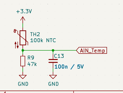

I am using STM32L412KBU and read in different ADC channels.
Now I see that the first read returns 23451, the second read immediately after returns 20338.
I use x16 OVS, hence the big numbers.
After the second read, values seem to become stable.
external circuit is as follows
ADC and pin config

Peter BENSCH
Anyway, the time constant of the resulting RC network is well into the millisecond range due to the 100nF, which must of course be taken into account. A pull-up in the order of 40kohms will also have a significant influence, which is why you need to give the system enough time to settle.

Peter BENSCH
Well, since in your case it is a high-impedance temperature measurement with some significant capacitor, which is therefore very slow, you should set the ADC from 2.5 cycles to the slowest 640.5 cycles.

b.a.
well, my thoughts went that way too
But I reasoned that it should only be relevant after powering up the system, not when it is running and I merely reset the controller...
changing to 640,5 cycles did not change the behaviour relevantly
b.a.
I also notice a drastic change in returned ADC value depending on if and where I set a breakpoint before the read.
Setting a breakpoint before the GPIO gets set to analog (line 1 in the below code) returns 39897
line 5 : 19913
Might this be because the pin was configured as input with pullup right before?

Peter BENSCH
b.a.
so this behaviour can be explained by the big capacitor and the fact the just before, the pin had the internal pull-up connected?
Peter BENSCH
Just give it a try.
