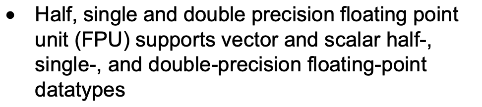

yes ...arm doku, what could be in the cpu ....but you have a STM N6xx , so ds N657 says :
So : float , but no double in hardware. Would cost 30 cents more...   :)
Hi AScha.3,
From the ST data sheet DS14791 Rev 5
