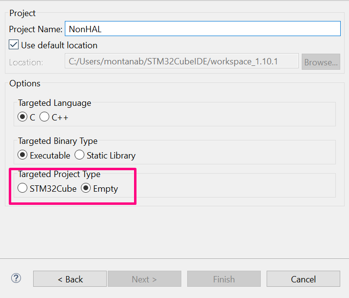

    My favorite would be "A simple way of creating a HAL-free project under CubeIDE without manually copying files from the depths of MCU packages". ;) Something which used to be the basic project creation scenario under most of existing IDEs.
    I came to some solution involving only file deletion, two simple editing changes and two modifications of project properties, which takes 2..3 minutes after creating the standard HAL project.

    Hi @gbm​
    Just a minor suggestion here, but upon project creation with STM32CubeIDE you can select this option:
    0693W00000Y7PRbQAN.pngThis will create a HAL-free project, which only contains the startup file, main.c and linker script that will compile, but you'd need to adjust the interrupt management.

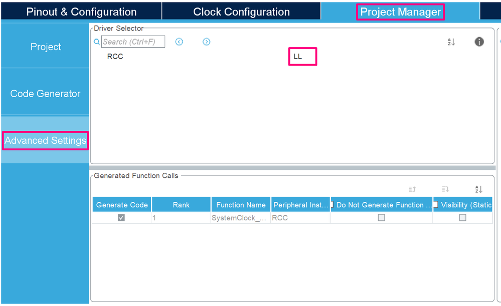

    Alternatively, if you want to avoid using HAL because of its memory footprint, you can use the *.ioc to change from HAL to LL for all IPs your project has:
    0693W00000Y7PSKQA3.pngIf you meant something different, please detail a bit more so we can work on some tutorial for it.

    January 5, 2023
    What you describe above creates not only a HAL-Free but also "MCU header-free" project (= unusable project). That's the problem with CubeIDE. Back in old Atollic times, it was possible to create an "empty" projects for a given MCU, containing the startup, SystemInit and the required header files. It's no longer possible with CubeIDE.
    I believe that "empty project" should contain basic (maybe empty) SystemInit() and the required MCU-related header files - these are currently omitted.
    BTW: do you realize that whenever you create a standard HAL project, the Inc folder contains all the ARM processor related files, includingh the ones not needed by a selected MCU core. So, for example, when you select STM32L0, you get include files for Cortex-M3, M4, M7, M33 and SC300 in the Inc folder.
    It's another error in CubeIDE project creation.
