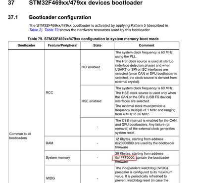

Is the address right? You can get the address at AN2606.
I did the same function at STM32F429 with the stdlib.It works sucessfully.
#define BootloaderAddress    0x1FFF0000
