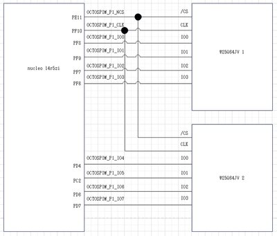

The connection diagram of the board and FLASH is shown below.
I want to send Write Enable instruction to 「W25Q64JV 2」.

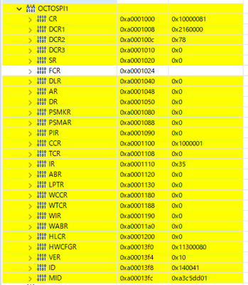

The registers are set as follows.

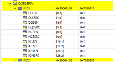

●OCTOSPI
●OCTOSPIM
I send Write Enable instruction and then the Read Status instruction. 0 is always stored in the FIFO. (Of course I make sure the FTF is set before reading the data register)
I assume that the setting on the microcontroller side is wrong because when I check IO5 with an oscilloscope, I get the expected waveform.
For your information, when I set FSEL to 0 and communicated with 「W25Q64JV 1」 using IO0~IO3, the data was stored in the FIFO as expected.

I changed the IO5 pin from PC2 to PG11 and now the data is stored in the FIFO as expected.
The problem has been solved and is closed.
