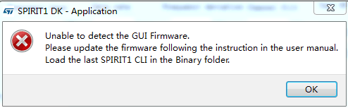

Hello everyone:
i met a big problem, now i am using Nucleo L073RZ board and x-nucleo-ids01a5 expansion board to do the point to point communication. i want to use SPIRIT1 DK to receive and analyse the data. however, i can not open the com, it always shows the below figure, but my virtual ports have been installed correctly. could you please help me.0690X00000606xYQAQ.png0690X00000606z0QAA.png

Posted on May 17, 2017 at 06:16
Dear D:
so sorry to bother you again, i follow all installation instructions. however, the result is disappointed.  i try to use another board to test whether i can use SPIRIT1 DK to open the com, but failed.it seems that virtual Com port of Nucleo-L073RZ is correctly connected to the PC, it may be the issues of spirit1 DK,the figure shows 'unable to detect GUI firmware', but i can not find GUI firmware in the SPIRIT1 DK installation package. then i tried to search GUI firmware on st.com but there are no discovery. the version of SPIRIT1 DK is 2.2.1, and my PC is win7 64 bits. whether i need to use old version or the latest SPIRIT1 DK could not be compatible with the Nucleo-Lo73RZ and X-Nucleo-IDS01A5.
