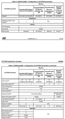

i am using nucleo-h563zi and want to communicate a W25N01GV is there any code avaible for communication for using external flash memory

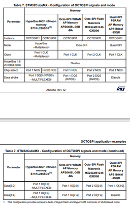

Hello @Aryan_vats_15 and welcome to the community;
You can use the OCTOSPI interface to connect the external memory.
I recommend you to refer to AN5050 precisely section 7 OCTOSPI application examples and get inspired to configure W25N01GV.
Also, I think STM32CubeH5/Projects/STM32H573I-DK/Examples/OCTOSPI at main · STMicroelectronics/STM32CubeH5 · GitHub examples can help you.
Thank you.
Kaouthar
