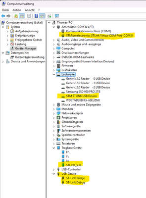

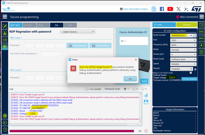

i have a new EVLSERVO1 and a STLINK-V3SET ant try to program my MSDK 6.4.0 generated firmware but i am not able to connect to the bord.
I use the latest STMCubeProgrammer 2 20.0 and the latest stsw-link009 USB Driver.
I updated the Firmware on the V3 to the latest version. And i tried both variants of the firmware.
The Software recognizes the V3 Hardware and reads the 3.3 Volt from the ELSERVO1 board.
i tried to use a Win10 and a win 11 machine.
But I am not able to connect or to flash the Board.
The 14 pin cable to the board seams to be ok.
I am able to connect and flash other STM Boards with this setup like the STM32H745I-DISCO.
Is there anything I have to set to achieve a connection?
I also tried the UART1 connection with Tera Term without success.
Do I have to send the Bootloader activation patterns 15?

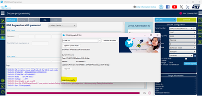

Hello @THöfl.1,
Using the STMCubeProgrammer tool, did you try to upgrade the ST-LINK firmware version?
If you agree with the answer, please accept it by clicking on 'Accept as solution'.
Best regards.
GMA
Yes i tried both variant's.

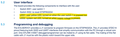

Did you switch on the DC power supply input?
Did you review the evlservo1 um3375  user manual document?
Best regards.
GMA
Hello, Yes the DC Power is on and the 3,3 Volt are recognized by the V3 debugger and LED 1 and LED 2 are showing the supply voltage as described in the Manual.
Regarding the flash proses i do not find to many hints in the Manual.
