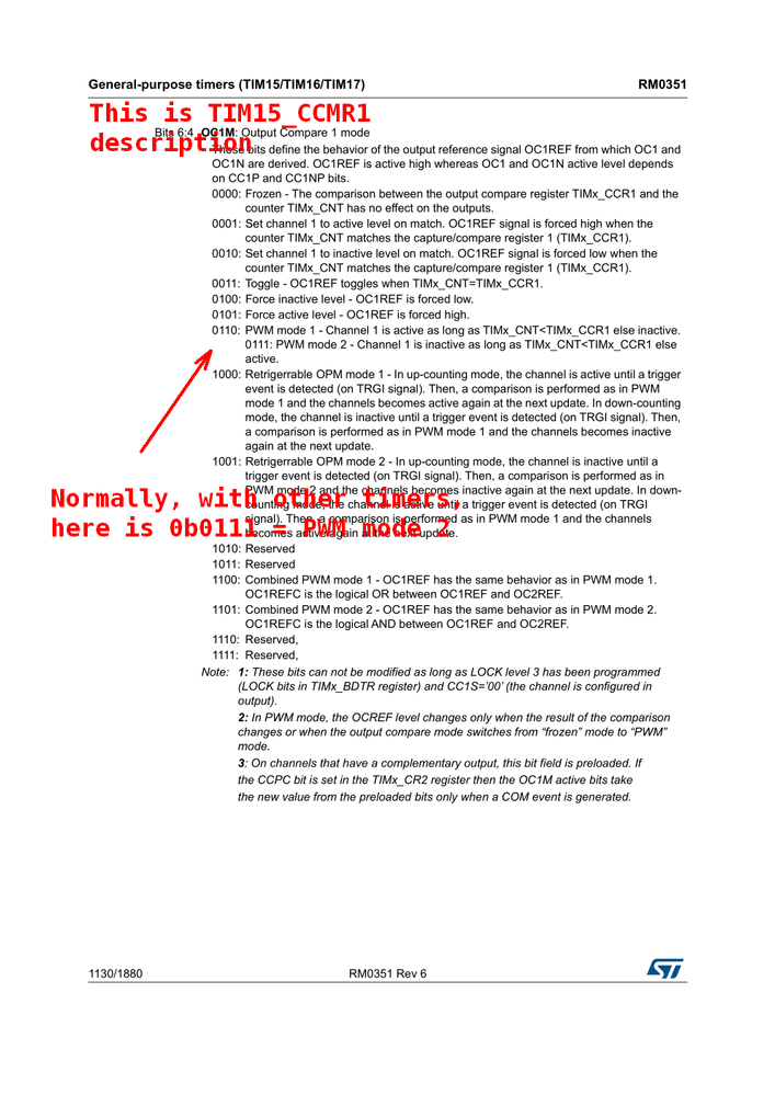

Is there no PWM mode 2 in STM32L4x5/6 TIM15, or is it just another typo?
waclawek.jan
@Imen DAHMEN​
Imen.D
Ok, this noted for fix.
Thanks,
Imen
Thanks
Imen
3 REPLIES 3
berendi
Principal
Look at it again, it's right there, just the indent is wrong.
waclawek.jan
Oh.
Indeed.
Thanks, @berendi​ .
Then, the indent should be fixed... :)
Jan
