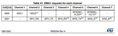

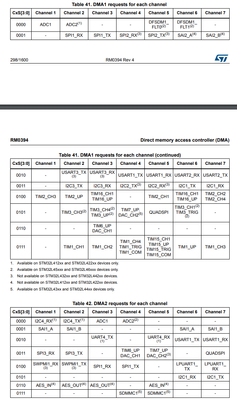

If you look at the reference manual RM0394 tables 41/42, there is no DMA request to the CAN peripheral:
So no CAN transfers with DMA.

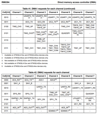

Tables 41 & 42 show you which peripherals have DMA capability:

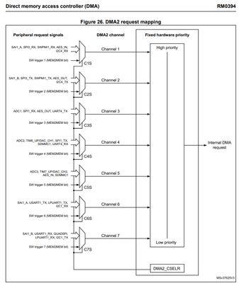

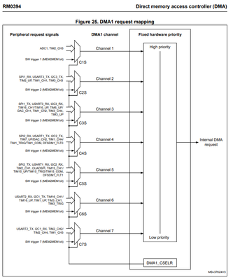

See also Figures 25 & 26:
