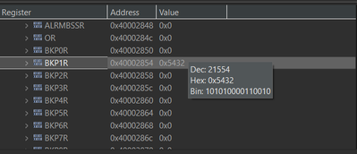

I am using the Internal RTC of STM32F767 MCU.
The VBAT pin is connected to an External 3.3V Coin Cell Battery
At Power ON (Debug window on STM32 Cube IDE), before HAL_INIT when i see the value of RTC BKP1R Register it is 0x5432 as I intended it to be.
Then there is system clock config
void SystemClock_Config(void)
/** Configure LSE Drive Capability
__HAL_RCC_PWR_CLK_ENABLE();
HAL_PWR_EnableBkUpAccess();
__HAL_RCC_RTC_ENABLE();
__HAL_RCC_LSEDRIVE_CONFIG(RCC_LSEDRIVE_HIGH);
__HAL_PWR_VOLTAGESCALING_CONFIG(PWR_REGULATOR_VOLTAGE_SCALE1);
RCC_OscInitStruct.OscillatorType = RCC_OSCILLATORTYPE_HSE|RCC_OSCILLATORTYPE_LSE;
RCC_OscInitStruct.HSEState = RCC_HSE_ON;
RCC_OscInitStruct.LSEState = RCC_LSE_ON;
RCC_OscInitStruct.PLL.PLLSource = RCC_PLLSOURCE_HSE;
RCC_OscInitStruct.PLL.PLLM = 25;
RCC_OscInitStruct.PLL.PLLN = 432;
RCC_OscInitStruct.PLL.PLLP = RCC_PLLP_DIV2;
RCC_OscInitStruct.PLL.PLLQ = 9;
RCC_OscInitStruct.PLL.PLLR = 2;
Error_Handler();
/** Activate the Over-Drive mode*/
if (HAL_PWREx_EnableOverDrive() != HAL_OK)
Error_Handler();
RCC_ClkInitStruct.APB1CLKDivider = RCC_HCLK_DIV4;
RCC_ClkInitStruct.APB2CLKDivider = RCC_HCLK_DIV2;
if (HAL_RCC_ClockConfig(&RCC_ClkInitStruct, FLASH_LATENCY_7) != HAL_OK)
Error_Handler();
and then there is
HAL_Delay(100);
/* USER CODE BEGIN SysInit */
backup_value_rtc_4(uint32_t) = hrtc.Instance->BKP1R;
now surprisingly this reads 1517797662 but it should be 21554 (0x5432)
so when i do MX_RTC_Init

then my RTC gets written everytime.
Now SFR says 5432 is stored, why am I not able to read it correct using the API or directly accessing the register
1 REPLY 1
waclawek.jan
And what is value of hrtc.Instance?
