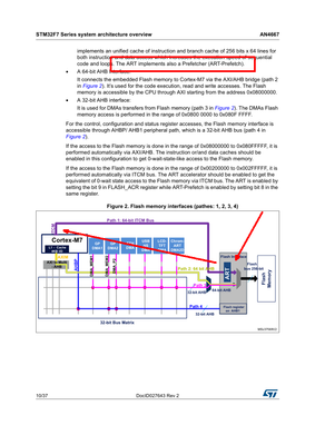

ART makes a prefetch, but also the Cortex-M7 without ART makes the prefetch if it is enabled. In fact I can disable ART and enable the prefetch. In the document https://www.st.com/content/ccc/resource/training/technical/product_training/group0/8d/11/c5/6d/be/15/4f/63/STM32H7-System-ARM_Cortex_M7_M7/files/STM32H7-System-ARM_Cortex_M7_M7.pdf/_jcr_content/translations/en.STM32H7-System-ARM_Cortex_M7_M7.pdf at page 4 there is a figure in which the prefetch unit is linked to I-Cache.

There are two caches in this regard: one is the 64 lines of ART, which is on the ITCM feed from FLASH; and other is the L1 cache on the AXI-processor interface. It's the latter which is usually called ICache and that's probably what @GGran.2 had in mind when writing "in the same time disable ICache".
Prefetch, as being explicitly enabled by FLASH_ACR.PRFTEN, is part of ART and thus on ITCM. Lines fetched by the prefetch may end up in ART, but only when actually fetched by the processor - that's probably what you are talking about above. One extra note, it's not only *instructions* which are fetched thorugh ITCM, but also *data literals*, and both end up in ART if actually read by processor.
As ART is on the ITCM, lines prefetched by the prefetch in ART can't end up in the L1 cache as they don't reach/travese the AXI matrix.
However, the L1 cache itself can perform speculative reads, which from "traffic" point of view is the same thing as prefetch, i.e. accesses FLASH without having an acute need for the fetched line. It does this in order to actually store that line into the cache and does so without the processor actually reading it, in the anticipation that it may do so in the future and that then might spare the waitstates associated with FLASH and any other latencies across the AXI matrix. It does not do this if it's disabled, of course.
