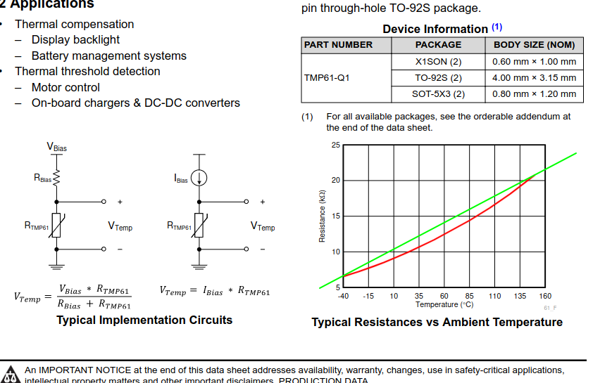

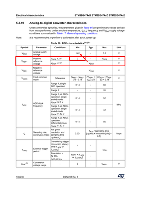

We are designing a simply cost sensitive Temperature sensing solution using low-cost Linear Thermistors TMP61Q1 from TI, and wish to use the internal ADCs on STM32G474RCT3 MCUs, this is an LQFP64 package with a dedicated VREF Buffer Pin which can drive output loads at 2.048V, 2.5V, 2.9V with 6.5mA.
We wish to understand in detail, can we use this VREF BUFF pin and add an external voltage reference of say 1V & then reduce the ADC input voltage swing to 0-1V for the entire 12-bit dynamic range?
Or can we set the VREF Buffer to 2.048V & use the ADC with VREF Internal channel such that the ADC Voltage swing becomes 0 to 2.048V for entire 12-bit range?
Or can we simply supply VDDA 1V & keep the ADC maximum voltage swing between 0 to 1V for the entire 12-bit resolution?
Kindly guide us with this use case, as the sensor output has a limited voltage swing & using a non-inverting amplifier is not a feasible option cost-wise.

> You can use an external reference of 1V.
As TDK already wrote above, you can't.

Lead
About sensor curve, TMP61-Q1, it reminded me of sensor curve KTY84. In the KTY84 datasheet it says that it is "Virtually Linear" note that there is a deviation, the curve is not completely linear (which would be a straight line, not a parabola) some compensation may be needed depending on the range and accuracy desired. On a device that uses the KTY84 I had to deviate the extremes via trimpot calibration, so that the center of the curve was closer to the average.
I am including the TMP117 sensor (+/-0.1°C) in another project that was operating with the DS18B20. This TMP117, despite being expensive compared to a thermistor, seems to be worth it, since it is a digital sensor, I2C bus (it could be even better if it were 1-wire like the DS18B20).
