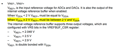

On default VREF+ pin in an input. You can connect an external reference to this input, then the max level for the ADC input is the VREF+ voltage. EDIT: You can't use an external référence of 1V.
The VREFBUF is not a pin but a switch to connect the internal reference voltage to the VREF+ pin.
The VREFBUF is used to set the VREF+ pin as output. The max level for the ADC input is also the VFERF+ voltage.  In this mode the allowed VREFBUF voltage depends on the VDDA voltage.
In your case  you must use an external reference connected to the VREF+ pin and ignore VREFBUF.
14 REPLIES 14
There are limits on the range of allowable voltages on VREF+ which can be found in the datasheet. If you are tying VDD to VDDA, generally it's going to be limited to 2V+.
If you handle VDDA separately, you can get down to 1.62V.
In either case, you can't get down to 1V for the entire 12 bit swing.

You can't use VREFBUF and external référence at the same time.
There is only one reference for all ADC channels.
Temperature acquisition is slow. One can imagine switching external references to VREF+. But you say you are reluctant to add external components.
As @MasterT  points out you can use one of the MCU's internal OPAs and a PGA to amplify the only problematic channel: ADC1.
