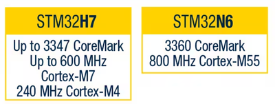

July 25, 2025
The speed here is a bit deceptive. The dual core isn't 600 MHz, it's only 480 MHz. And the H7 is a mixed bag of configurations.
STM32H743 1027 DMIPS (480 MHz)
STM32H745 1027+300 DMIPS (480 MHz)
STM32H723 1177 DMIPS (550 MHz)
STM32H7R3 1284 DMIPS (600 MHz)
As I recall the H6 is in a different process technology, and is predominantly RAM
STM32H6 1352 DMIPS (800 MHz)
https://www.st.com/en/microcontrollers-microprocessors/stm32h7-series.html
https://www.st.com/en/microcontrollers-microprocessors/stm32n6-series.html
CM4  1.25 DMIPS/MHz (1.27 w/FPU)
CM7  2.14 DMIPS/MHz
CM55 1.69 DMIPS/MHz
https://en.wikipedia.org/wiki/List_of_ARM_processors
Would tend to think we'd need to benchmark our own niches, and see what algorithmic improvements one might make with more RAM, faster FPU or NPU accelerators, etc.
Andrew Neil
July 25, 2025
@Tesla DeLorean wrote:
The speed here is a bit deceptive. .
Indeed:
As with so many of these "up to..." claims, they often don't apply together!
Hence why I asked @DJ_IND earlier to be specific about what "H series" part(s) is/are currently being used.
