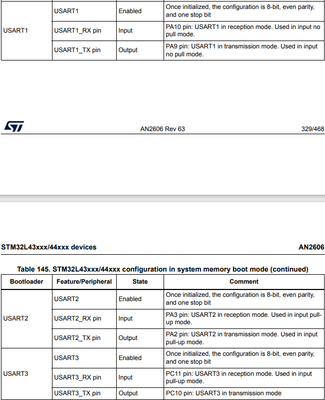

Hey, thanks for the reply.
Is it possible to flash the firmware using GPIO pins via UART? I would not want to use microUSB anymore. This is because my company is building a tool with other components and it will be difficult to open the packaging every time to connect the microUSB and flash.
Your inf is little chaos, from where you have here micro USB? But primary you can use own bootloader = any custom method and connection for fw, or sytem bootloaders as described in AN2606 actualy chapter 66 pages 329-...
Hello @Abijith
The bootloader is also available on the UART interface for the STM32L432KC:
Best Regards.
