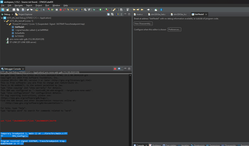

STM32H5 Cannot enter system bootloader from software
ugurtumer4

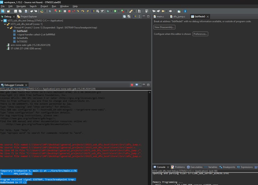

0x0BF97000 (system bootloader base per AN2606): the jump appears to succeed (In Debug reaches the bootloader region), but execution then breaks at an address inside the bootloader ROM with no further progress and no USB enumeration. The hardware boot path works correctly. The problem is purely on the software-jump path.
I created an empty project in sample you can download and test it. I also attached my option bytes (i think everything is default).
MCU: STM32H573 (also tested h523)

Hi @mƎALLEm, thank you for your reply.
I already checked and tested this code, it didn't work in STM32H573I-DK. same error with my code
'Break at address "0xbf9ede0" with no debug information available, or outside of program code.'
