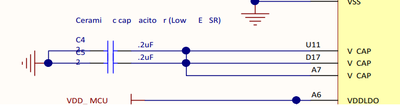

My Schematic:
VBat, all Vdds, Vdda, VRef, PDR_ON are all connected to 3.3V
all GNDs and AGND are connected to GND
each Vcaps (2x) has a 2.2uF capacitor (alltough i am not sure about its esr)
each Vdd pin has its own 100nF or 1uF cap.
=> See stm32schematic.pdf

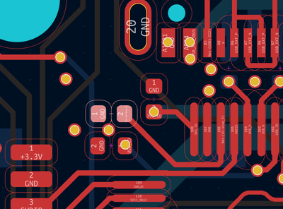

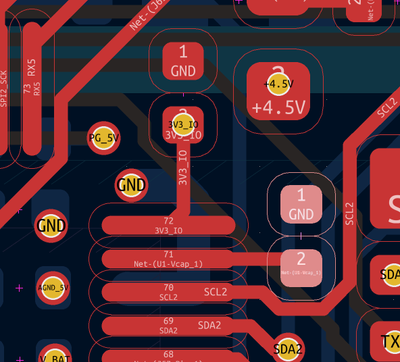

My Layout:
Vcaps:
For Vcap pins, you need just 2x 2.2uF and all VCAP pins need to be connected together.
Please refer to the AN4938 "Getting started with STM32H74xI/G and STM32H75xI/G " and check again your hardware based on the recommendations and the reference design provided in the section 8 Reference design.

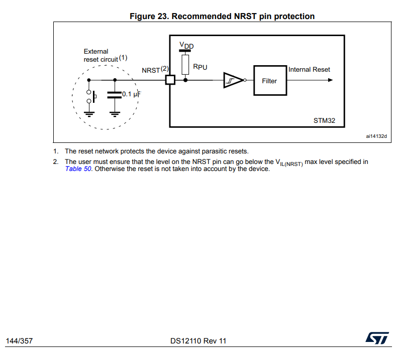

You don't have NRST on the debug connector, and a I don't see the recommended capacitor on it.
As @mƎALLEm said, see the hardware development app note, AN4938.

i have the rst pin on a pad wich i connected to the jlink

Ok, So vCap pins need to be connected. I will solder a new board and manually connect the vcap pins.

Adding a pullup Resistor to NRST solved the problem.
Thanks for your help!
