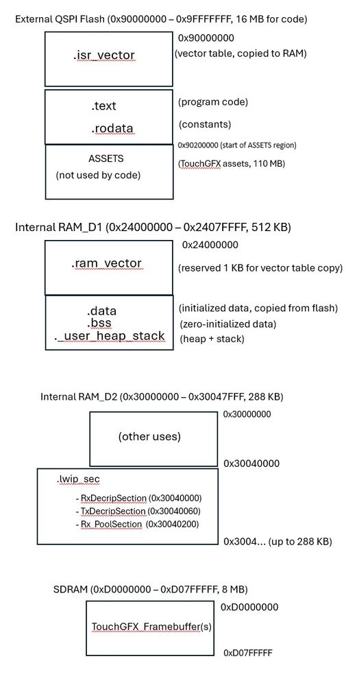

As mentioned in the comments in the article, you are getting a white screen because the MPU is misconfigured. You have set Region number 5’s AccessPermission to MPU_REGION_NO_ACCESS instead of the "All Access Permitted" option mentioned in the guide.
MPU_InitStruct.Number = MPU_REGION_NUMBER5;
MPU_InitStruct.BaseAddress = 0x30020000;
MPU_InitStruct.Size = MPU_REGION_SIZE_128KB;
MPU_InitStruct.TypeExtField = MPU_TEX_LEVEL1;
MPU_InitStruct.AccessPermission = MPU_REGION_NO_ACCESS; /* <----- */
MPU_InitStruct.IsCacheable = MPU_ACCESS_NOT_CACHEABLE;
Best regards,

Based on your advise, please note this diagram of various memory regions usage to be adoptedMemory_regions_usage.jpg
please advise

Hello @ksale.1,
You are missing some key configurations. I suggest you carefully follow the article, especially the MPU section, for the application to work correctly. Also, please ensure that the netmask you set matches the one on your computer used to ping the board (e.g., 255.255.255.0); otherwise, the application will not respond to pings.
Best regards,
To improve visibility of answered topics, please click 'Accept as Solution' on the reply that resolved your issue or answered your question.
