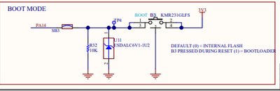

Hello @NotThomasEdison
I attempted to boot the device into the system bootloader using a Nucleo board, and the boot sequence works as expected on my setup.
Please take a look to the schematic of NUCLEO-C071RB
Saket_Om

What do you use for setting BOOT0 high? A mechanical switch?
Do you see any difference whether you set nRST low and high, or if you power cycle the microcontroller?
I used the boot mode button which set the pin BOOT0 to high.
I click on boot mode button to set BOOT0 pin high then click on reset button.
Saket_Om
Ah! I had missed that you were using a Nucleo board. Sorry.
Try holding the boot mode button pressed while you click the reset button. If you click and release the boot button before you press the reset button, the BOOT0 pin will no longer be high when you reset.

What do you use for setting BOOT0 high? A mechanical switch?”
I am using a separate microprocessor to electronically (via 3V3 gpio) to pull the nRST and BOOT0 values high/low rather than using a button system.
While the nRST is low my application code does seem to stop (whether the BOOT0 pin is high or low) and as soon as the nRST is high it starts the application code again.
I haven’t tried power cycling it yet but will give it a try in the next 24hrs!
At least that's good.
And do you keep the BOOT0 pin low while nRST goes high? That is where it matters.
It doesn't matter what logic level you have on BOOT0 while nRST goes low. It is when nRST it goes high that the microcontroller can "decide" to start the bootloader.
