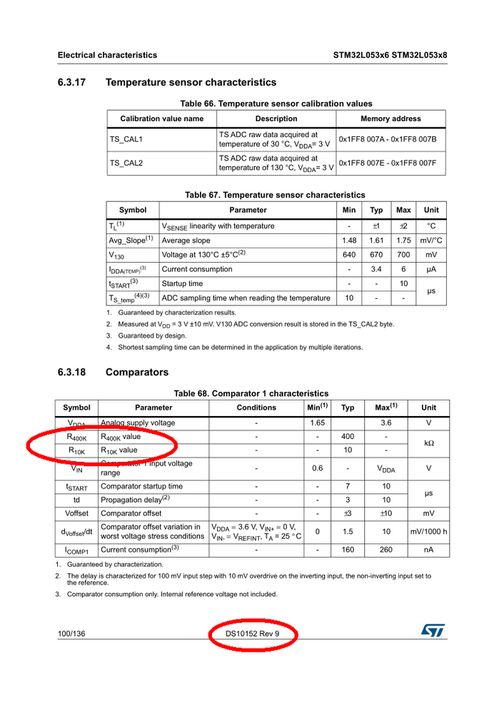

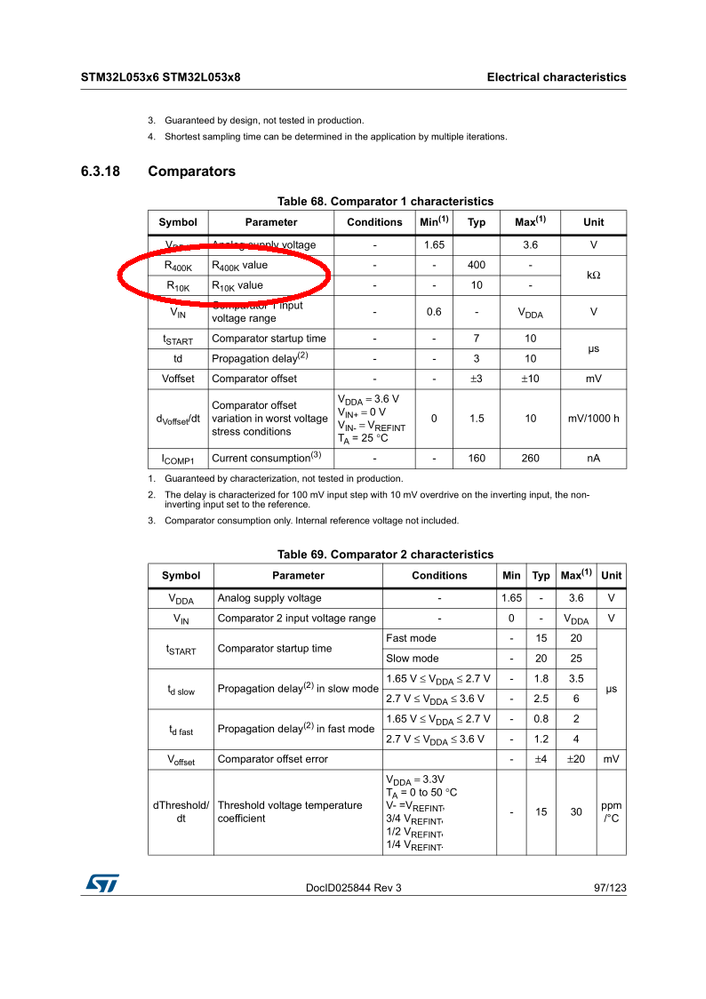

In STM32L0, what is R400k/R10k?
waclawek.jan
I see it also in other 'L0xx datasheets, yet no mention of it in the respective RM.
12 REPLIES 12

Imen.D
Hi @Community member​ ,
Those data R400k and R10k should not appear in STM32L0 datasheets !
I raised internally a request to update and remove those data from the STM32L0 datasheets.
Thanks for your contribution.
Kind Regards,
Imen
Thanks
Imen
waclawek.jan
Thanks, Imen.
Jan
and the details slip back into the darkness....
Suppose it's calibration for ADC or COMP
Clive,
in the 'L1 RM, there are switchable pulldowns/pullups on the comparator input. My guess is that this was a purpose-designed feature for a key customer. I wouldn't be surprised if this was intended to measure capacitance, for whatever reason. And, again a guess, to spare area, the resistors were kicked out when the COMP cell was migrated to 'L0; the values got into the datasheet through copy-paste.
Jan
waclawek.jan
Hi @Imen DAHMEN​  ,
so, how exactly does this "internal request to update" work?
The following DS is dated 27.Jun 2019, whereas we've discussed this in December 2018.
Jan
Imen.D
Hello Jan,
Unfortunately, this is was missed to update in the new Datasheet as the request concerned all STM32L0 datasheets.
I will re-submit a new request and will push to correct this.
Thank you for your feedback and understanding.
Best Regards,
Imen
Thanks
Imen
waclawek.jan
Thanks, Imen.
Jan
Next STM32L051 datasheet updated in few days will integrate the correction.
