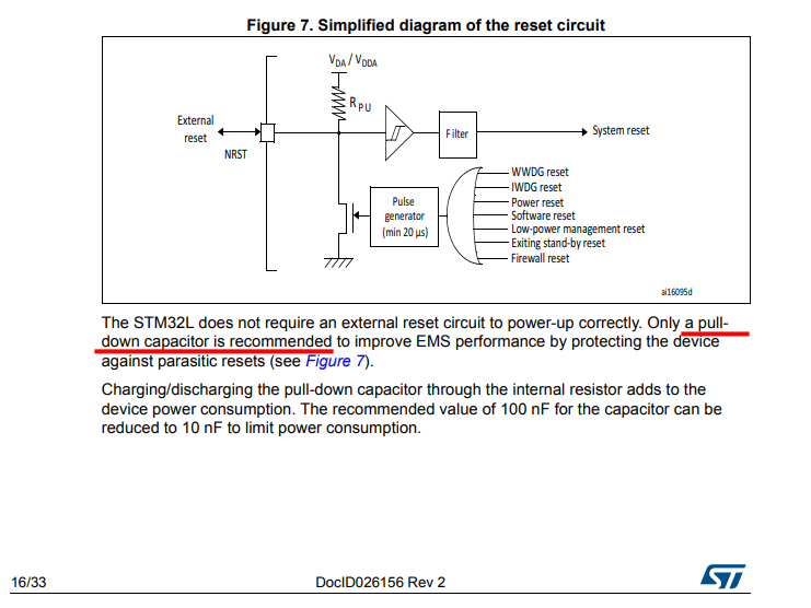

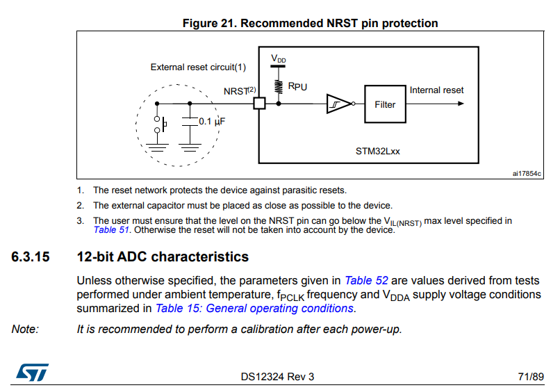

It's recommended to have a capacitor on NRST - you don't have that:

In the datasheet:
https://www.st.com/resource/en/datasheet/stm32l010c6.pdf
