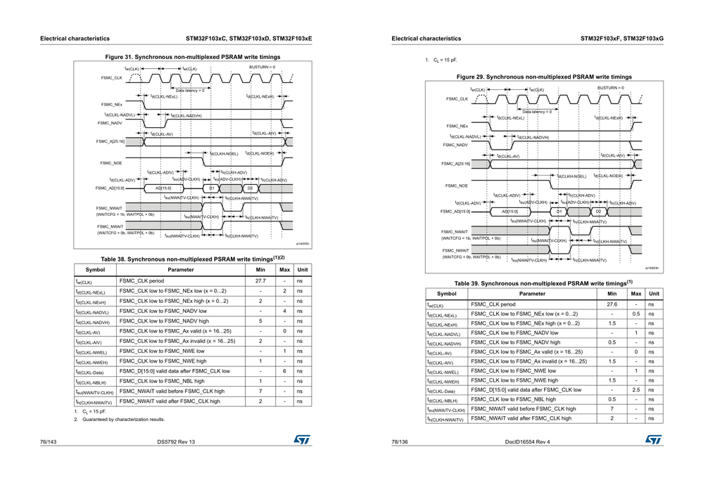

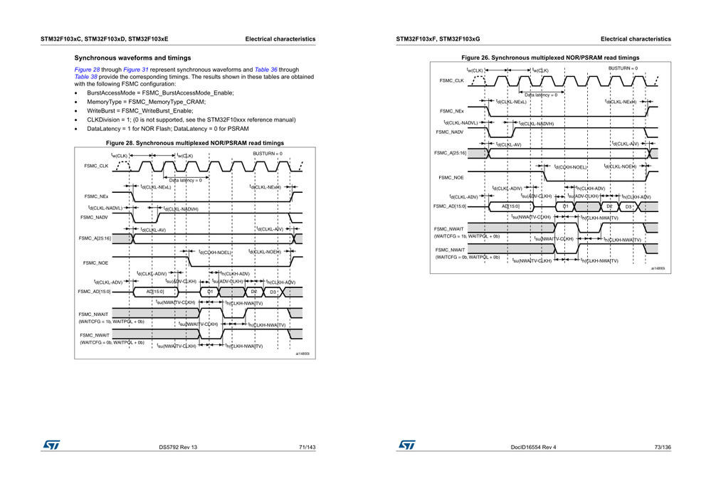

In STM32F103xx manual, Synchronous non-multiplexed PSRAM write timings gragh (76page, Figure 31) is wrong?? This is same Synchronous multiplexed PSRAM read timings(Figure 28).
Please let me know if the manual is wrong or if I'm wrong

correct and sorry for the mistake, the data sheet is wrong and shows the multiplexed timings in figures 28 and 31 of the data sheet DS5792 of the STM32F103xC, STM32F103xD, STM32F103_E.
A correct timing can be seen in figures 26 and 28 of the data sheet DS6558 of the STM32F103xF, STM32F103xG.

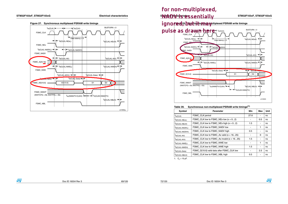

I freshly downloaded the DS from links you've provided and fail to see the difference between fig.28/'C'D'E and fig.26/'F'G:
0693W00000QLSgzQAH.pngwhereas fig.31/'C'D'E and fig.28/'F'G are completely different. However, fig.31/'C'D'E and fig.29/'F'G are again identical, and both wrong (or their caption is wrong - I now don't try to understand the "logic" behind FSMC's "modes" - I would like to, but it's a mess and ST never cared enough to produce the dozen of appnotes needed to clean it up):
0693W00000QLSiHQAX.pngJan

0693W00000QLQkaQAH.pngHi, ​above Figure 29 correct what i thought. where is this datasheet??  DS5792 & DS6558  are wrong.
