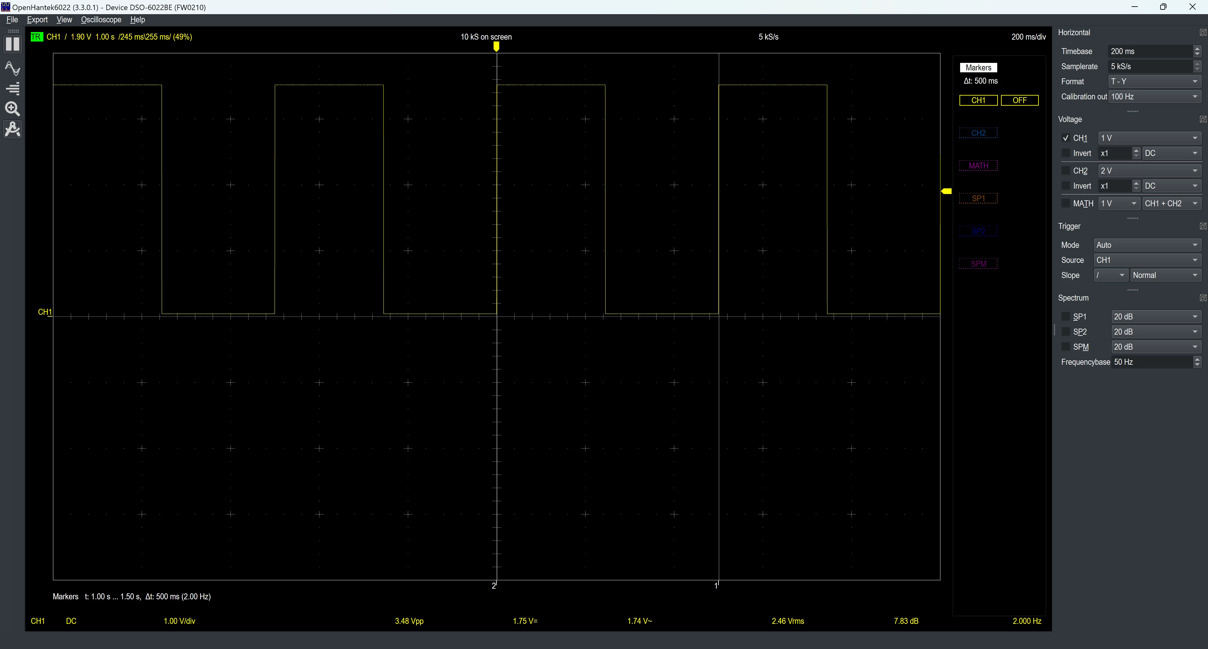

Here's my GPIO setup:
/*Configure GPIO pins : P_H_IN_Pin PCA_INT_Pin P_L_IN_Pin */
 GPIO_InitStruct.Pin = P_H_IN_Pin|PCA_INT_Pin|P_L_IN_Pin;
 GPIO_InitStruct.Mode = GPIO_MODE_IT_FALLING;
 HAL_GPIO_Init(GPIOJ, &GPIO_InitStruct);
I made a little code that calculates the time in milliseconds between interrupts and output it on the screen. I tested it on timer interrupts and it counts correctly.
Then I set up the PWM generator on a timer that gives 2Hz frequency with variable duty cycle. My reading is 250ms for 50% duty cycle, indicating I get the interrupt on BOTH EDGES! When I change the duty cycle to other values I get 2 interleaved readings, that further confirms I get the interrupt on both edges, because if only falling edge would trigger the interrupt, I would get the same reading no matter what the duty cycle is.
My question is HOW IS IT POSSIBLE? I observe the test signal on oscilloscope. It's a perfect square wave, no artifacts, no noticeable noise or jitter.
The only logical conclusion is I get the interrupt on both edges of the test signal, but why? That kills my application, because I have to measure short impulses repeated over a longer period (it's negative 0-3V3 PP, duty cycle around 5%).
What can be the reason the MCU ignores the GPIO setting and triggers the interrupt also for the rising edge? What should I check and test to further investigate the problem?
My device is STM32H747I-DISCO with TouchGFX application installed. The application seems to be working correctly, because when I provide interrupts from another timer as the impulse source - it measures the correct periods very accurately. The only problem I get is from EXTI line.
I get the interrupt from the HAL_GPIO_EXTI_Callback(uint16_t pin) function. I check the pin number. I also tested it for 2 different pins. Same results. Both inputs are configured to trigger the interrupt on the falling edge, but in both cases I get the interrupts from both edges.

As it would be very probable, it turned out it was a hardware bug I wouldn't expect. It turns out the software behaved correctly. There was indeed a rising slope, however, not visible on oscilloscope using the time base I used. It was a short spike introduced by a combination of a capacitor and the wiring. After removing the capacitance the device worked on the test signal from the PWM generator, however, it refused to work with the real sensor signal due to large, high-frequency spikes present in the singal. I solved the issue by replacing hardware edge detection with a software edge detection and a simple digital filter ignoring high frequency changes. It turns out the problem is low frequency counting with imperfect signal. The problem is really difficult to solve. It would take either additional input buffer and / or advanced digital filter. I'm testing adding some result averaging to provide a reasonable trade of between measuring accuracy and speed. I'm surprised how well H747 behaves sampling the signal at 50kHz.

To measure time between edges, timers are ideal. They are synchronous i.e. they sample and also incorporate digital filters on the input channels.
Contrary to timers, EXTI is asynchronous, i.e. it latches on the shortest possible pulse.
