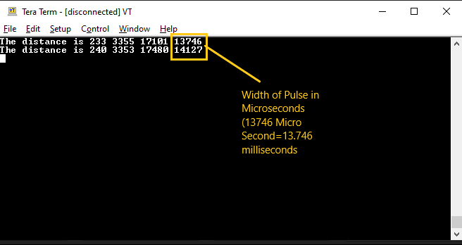

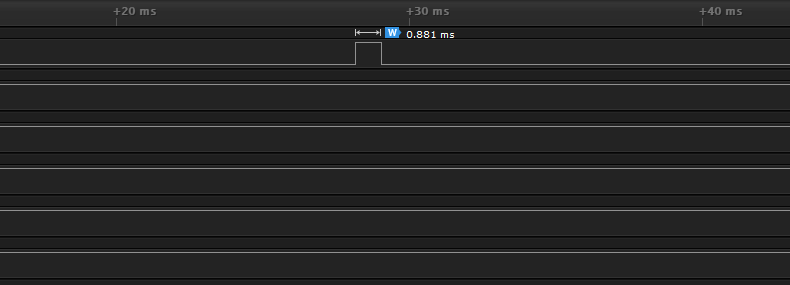

In input capture function , i am trying to interface HC-sr04 Ultrasonic sensor to STM32F401. I am giving input to TRIG pin with 10 micro seconds ON and Need to Measure Pulse from ECHO pin of the Sensor and not getting Exact Width.
‎2021-04-24 12:53 AM
The Pulse width value of the waveform in input capture is not matching with orginal Pulse from sensor output .
Please help.

‎2021-04-24 1:09 AM
TIMx_PSC is preloaded, you need to force update by setting TIMx_EGR.UG to get it "active".
‎2021-04-24 1:09 AM
‎2021-04-24 2:01 AM
Thank you again JW.
Now Project is working perfectly
