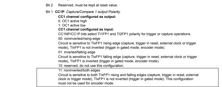

How to enable Capture/Compare 1 output Polarity(11: noninverted/both edges) in TIMx_CCER Register(STM32F401RE) but only 1 Bit is allocated for CC1P?
Nchun.1
Senior
In detail glance on RM0368 Reference manual. I am getting confused while enabling
CC1P -Capture/Compare 1 output Polarity(11: noninverted/both edges) in TIMx_CCER Register(STM32F401RE) .
Whether it is possible to change Output Polarity into both Rising/Falling Edges ?

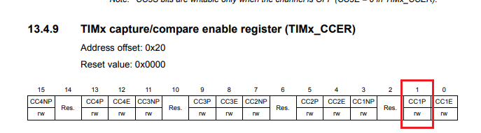

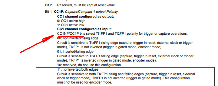

Somewhat confusingly, the other bit is CC1NP - but it's written there:
