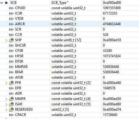

I'm trying use In App programming for the STM32L432KC board. Unfortunately there is no working example provided (app note AN4657 has STM3210C_EVAL and STM32L476G_EVAL which is dual bank).
I have managed to modify the example and written correctly the Flash (verified with debugger). The problem is when jumping to the address I get a hardfault_handler error.
The details of my setup are these:
I have separated flash in 2 areas since I don't have dual banks
area A 0x0800 0000
area B 0x0802 0000
I write my new binary (blink code) file in area B and I jump using the following code, where APPLICATION_ADDRESS=0x0802 0000 (area B):
     //SCB->VTOR = APPLICATION_ADDRESS;
     /* execute the new program */
     JumpAddress = *(__IO uint32_t*) (APPLICATION_ADDRESS + 4);
     /* Jump to user application */
     JumpToApplication = (pFunction) JumpAddress;
     /* Initialize user application's Stack Pointer */
     __set_MSP(*(__IO uint32_t*) APPLICATION_ADDRESS);
     JumpToApplication();
I read in this post that you need to add SCB->VTOR = APPLICATION_ADDRESS; for the interrupt vectors to initialize to the new address but I still get the error
inside the hardfault_handler I read the SCB and get the following
0693W00000AOWdmQAH.jpgwhich gives a BFSR register error at address 0x20010000 which points to a reserved space
Any ideas what I'm doing wrong ? According to the example you don't need to do anything else after you have loaded new program to flash. Just set MSP and jump.

Is the code present? You should check the values are valid before jumping, and perhaps checksum or sign the image.
Have you tried stepping into the code?
The VTOR looks to be zero, check that the SystemInit() on the application side sets the address properly.
What's the address of the fault?
What happens if you don't set the MSP, but rather set the SP in the app's Reset_Handler ?

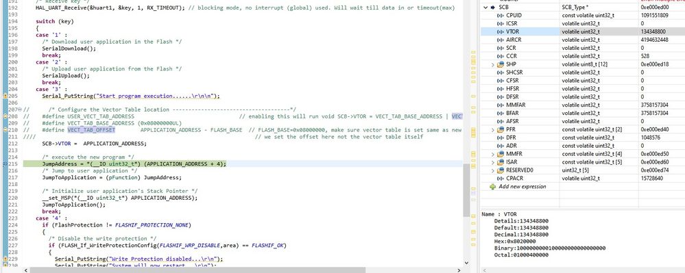

If I set SCB->VTOR = APPLICATION_ADDRESS;
without the defines I get the VTOR set correctly before jumping but after debugger crashes

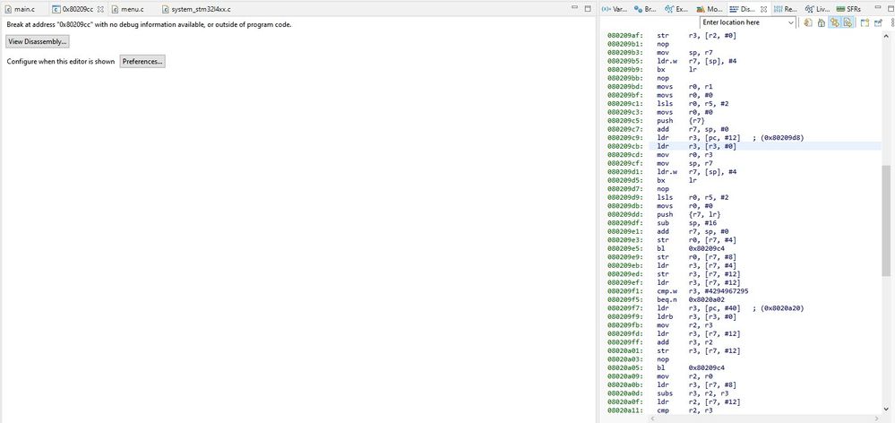

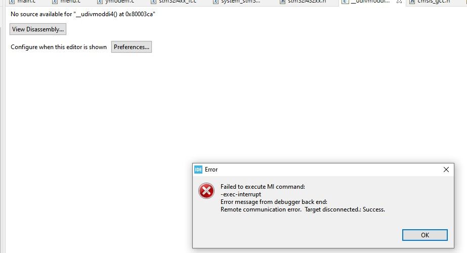

I added  __disable_irq(); before jump. Disassembly just before it crashes
0693W00000AOX6AQAX.jpg0693W00000AOX6UQAX.jpgAbout the link file. I don't see why I need to change it. I'm transferring a binary file.
Is the flash area to be written included in .bin file ? I need to have same file run in area A or B.
I understand the offset I need to change which is done by the line below , but still won't work ( I tried with my defines in my previous messages)
#define VECT_TAB_OFFSET       APPLICATION_ADDRESS - FLASH_BASE // (=0x0002 0000)
