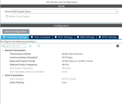

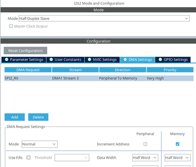

I am using a STM32F407 with the TLV320AIC3204 audio codec. I have verified that the I2S works with a logic analyzer:
I am trying to read the data using DMA (I tried both circular and normal).
Here is my I2S configuration:
I made sure to add the following line to fix the DMA bug:
__HAL_RCC_DMA1_CLK_ENABLE();

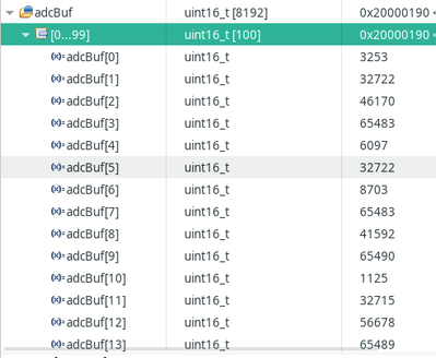

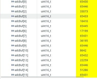

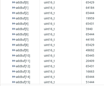

With lines 63 and 64 commented, I get random data sometimes (see picture below where I breakpointed on line 78, which is called after done = 1. You can see that the data is bit shifted by a random amount. There is nothing connected to the ADC, so the MSB should be close to 0xFFFF or 0x0000. However, these values are not.
I was able to fix the problem somewhat by uncommenting lines 63 and 64, which only allows the I2S to start when WS is low. (Trying it when WS=high gave me garbage every time). The issue now is that I am seeing the data offset by 16 bits sometimes.
For example, here, the MSB are in the even positions (all of the numbers in the even positions don't change very much, and are close to 0xFFFF):
However, if I wait until the breakpoint is triggered again, I get
Now the MSB is in the odd positions. Any idea why this is happening? With lines 63 and 64 uncommented, on most runs the MSB is in the even positions the first time, and every time after that the MSB is in the odd positions.

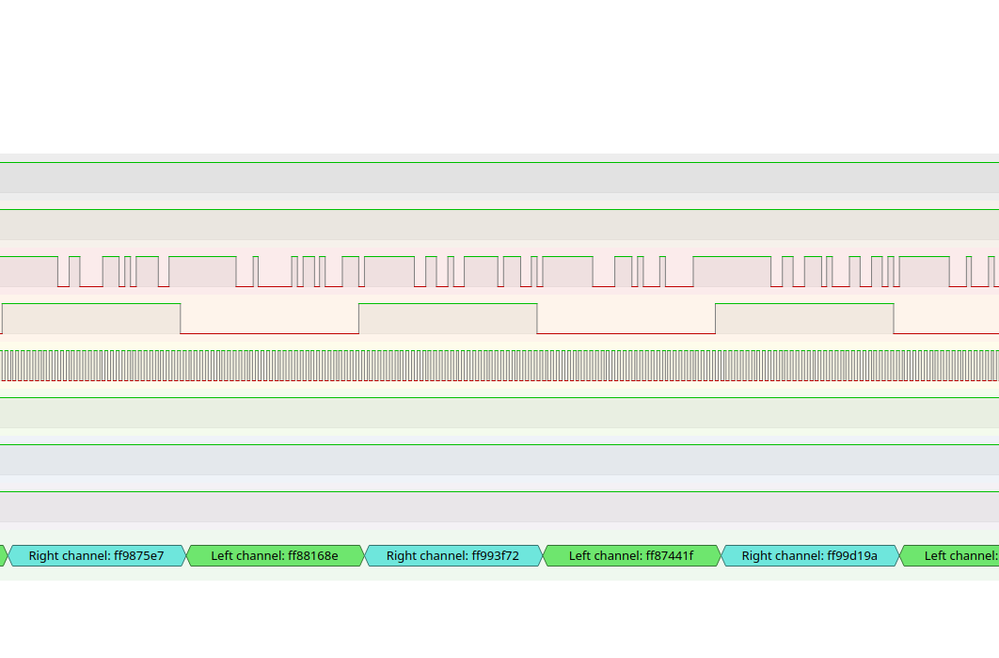

@TDK wrote:> There is nothing connected to the ADC, so the MSB should be close to 0xFFFF or 0x0000
I wouldn't ascribe any significance to the ADC result if nothing is connected to the input.
I checked with a logic analyzer and the output of the ADC was 0xFF..... (see picture attached). At the very least the first 16 bits should be at least 0xFF00 which is 65280. I also connected a 50 ohm load to the inputs, which did nothing.
