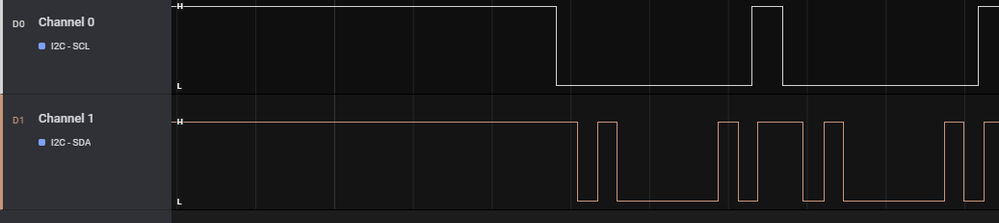

I am trying to get my I2C code Master working. I don't have the slave device connected and I am trying to see the output on a logic analyzer. I have connected the SCL and SDA pins to breadboard to a 2k pull up of 3.3V and the board is running at 3.3V. For some reason I cannot see the SCL toggling. It goes low and it stays low throughout the entire data address transmission period. Typically the scl and sda should have the address data and a NACK as there is no slave, but in this case the SCL is not toggling. Any suggestion how I can fix it? Thank you

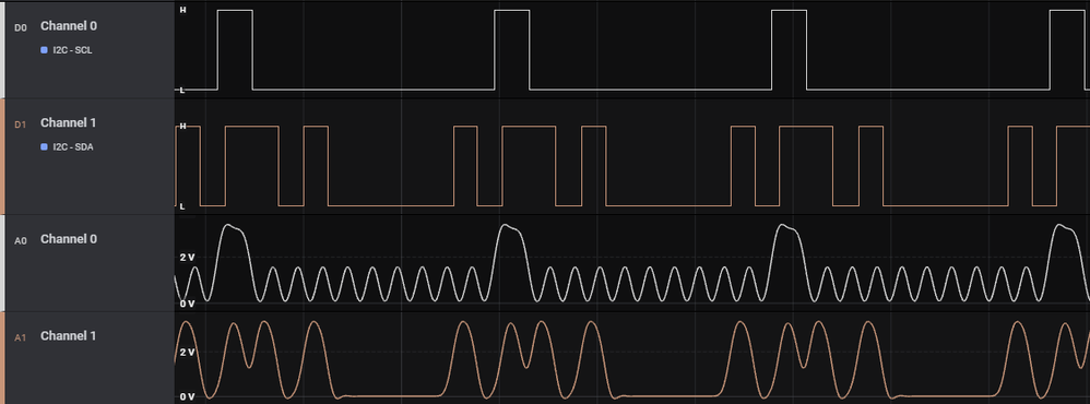

Show an analog trace. I would guess the pullup is insufficient.
VThan.2
Thank you. Do you mean on a scope?
Yes. It looks like you're using a Saleae logic analyzer which can take analog captures as well as digital ones.
VThan.2
Yes looks bad

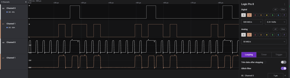

@TDK​ I tried increasing the resistance to 1K and my analog sampling to 50MS on logic analyzer and I seem to be getting the scl lines. I am not sure why the logic analyzer still does not see it. I still think there might be something to do with my settings on I2C line. Any thoughts?
VThan.2
Never mind, got it working the glitch filter was enabled on the logic analyzer. Fixed it. Thank you
