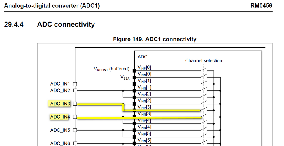

I am having some difficulty configuring STM32U575 ADC1 for Differential inputs.
The reference manual and auto-generated code seem to have conflicting information:
The ADC1 Connectivity diagram from Reference Manual (below) indicates configuring Channel [3] as differential will use ADC_IN3 to VINP (+ve) and ADC_IN4 to VINN (-ve).

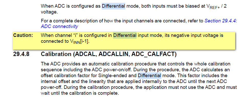

0693W00000JNRSdQAP.pngFurther down in the manual a note re: differential channels:
0693W00000JNRRzQAP.pngThe Caution note conflicts with connectivity diagram. It would suggest that when Channel 3 is configured for differential mode, then the +ve goes to VINP[3] and the -ve would go to input VINN[2].

The ADC init function first initializes ADC1_IN3 and ADC1_IN4. (matches the ADC connectivity diagram....so far so good)

Can anyone confirm if the connectivity diagram from the reference manual is correct?
1 REPLY 1
Tvoge.1
I have it working now and can answer my own question for others who may have same issue:
  • The ADC1 Connectivity Diagram (Figure 149 in the stm32u575 ref manual) is correct. Use that as your guide.
  • The Caution note in section 29.4.7 of the manual is not correct.
