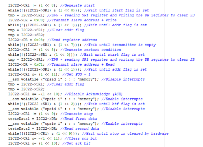

However, there is a change only in registering DR and CR1. In CR1 I cannot set the ACK bit at the end and the PE bit is cleared after setting the POS bit, making it impossible to set it or start a new communication, as the START is not generated.
Below the code used.
