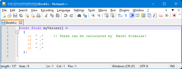

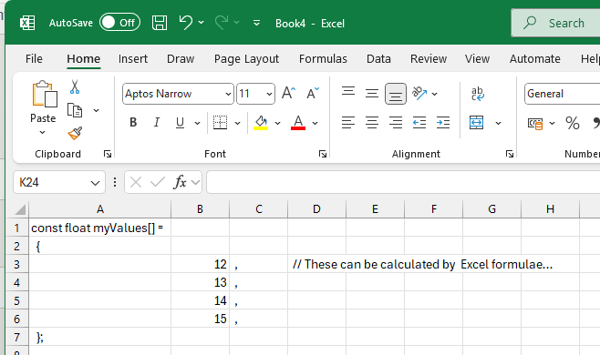

@mfgkw wrote:
even a comma separated values file like from excel.
I would even include the C rubric in the Excel file; eg,
Then you can just save as text, and give it a .c filename:
(note the quotes - otherwise Excel will save it as Book4.c.txt)

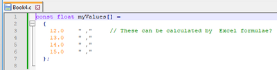

and there's your source file:

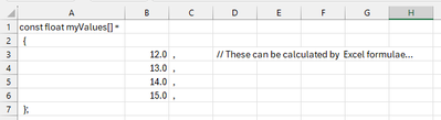

PS:
Sorry, forgot to make them float constants - but that's just a matter of the formatting in Excel:
#GenerateCfromExcel #CSourceFromExcel
