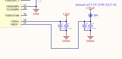

STM32H725VGT3TR Vref changes when I enable ADC1
RallyTronics
I have my internal Vref set to 2.5V (stage 0).
The value reads correct (2.52V) with a meter on the test point below until I call HAL_ADC_Start_DMA().   Once HAL_ADC_Start_DMA() -> ADC_Enable() -> LL_ADC_Enable() is called the voltage goes up to around 2.9V.
Any thoughts as to why this is happening?
Thanks!
Are you converting channels out of bounds? (above 2.5 V?)
4 REPLIES 4
RallyTronics
No, I am currently trying to digitize a 1V DC test signal.
RallyTronics
Let me double check my unused channels.
RallyTronics
Looks like that's the problem.
