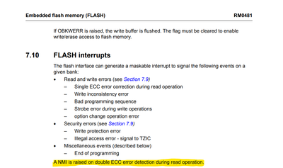

The NMI fault can be due to an ECC error detection. Could you check this point please?

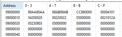

The memory content is:

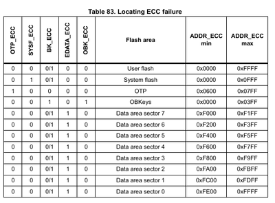

What corresponds to the device behaviour. I have doubts about ECC error address:
Register description: The address in ADDR_ECC is relative to the flash memory area where the error occurred (user flash memory, system flash memory, data area, read-only/OTP area).
The address pointer is 0x3000 and 0x3001 what correspond to user flash (7.9.10)

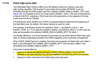

The errors you are experiencing may be due to accessing the high-cycle data area of flash memory (0x0900_0000 - 0x0901_7FFF) before it has been properly enabled and configured. Please ensure that the EDATA enable and start configuration bits are correctly set prior to accessing this region, as per the reference manual.

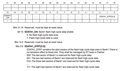

FLASH_EDATA1R_CUR just before and after is 1000 0000 0000 0111, what means that flash high-cycle data is enabled and the last eight sectors of Bank 1 are reserved for eeprom emulation:
In that case I ought to be able to read any data between 0x0900 0000 and 0x0900 BFFF. Correct me if I am wrong.
