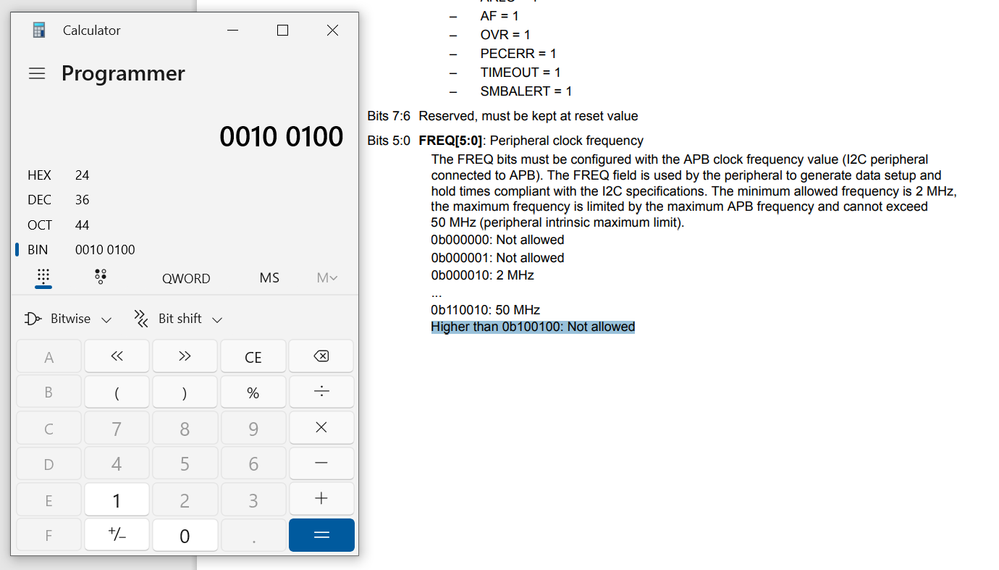

Foued_KH
Hello @placidity.master_gmail.com​,
The maximum APB frequency :50 MHz.
The maximum peripheral clock frequency : 36 MHz
This condition is respected :
0693W00000WLB5RQAX.png==> Higher than 36 MHz not allowed.
Foued.
and the line above says about 50 MHz, almost in one place two contradictory installations.
The frequency is limited by 50MHz ( max APB frequency) but cannot exceed the 36MHz.
