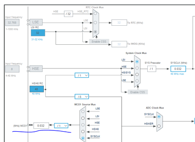

Im trying to run SYSCLK from LSI on a STM32C011. But it appears as if the MCU is not running. I cant see anything in the datasheet that says the clock cant be used and it can be routed fine in the clock configurator. Am I missing something in the datasheet or does the HAL not support it?

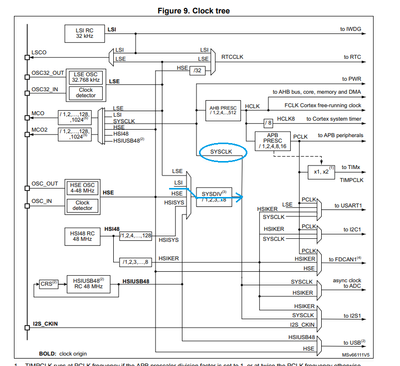

Nothing prevents you using LSI as a clock source for the system clock. From RM0490:

I have set the clock as shown. I have verified that I get no clock out when I use LSI. I also have a serial port configured. Again, everything works fine when using HSI as source for SYSCLK. Nothing happens when I use LSI.

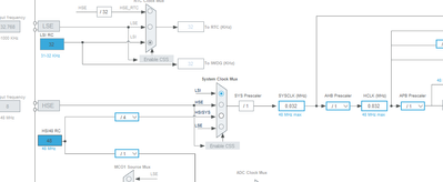

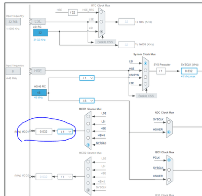

I have used the following clock setting.
I use the MCO to verify if SYSCLK is running. I also have a serial port to confirm activity.
It all works fine when using HSI. I doesnt work with LSI. It cant even run an endless loop toggling an IO.

I get MCO with HSI.
I do not get MCO with LSI.
"I use the MCO to verify if SYSCLK is running." is what I said. Does that not tell anything? I would normally use it to validate if my MCU/SYSCLK is running.
