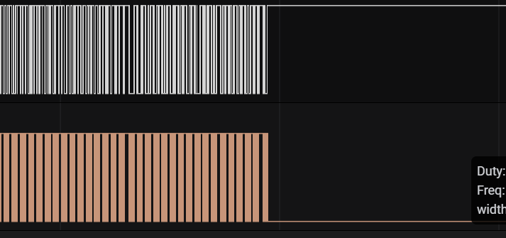

Hello, Thank you for your time and reply. Here is a screen capture from a logic analyzer.
Sorry I am still confused. I am trying to get an address acknowledge. Shouldn't my initiated interrupt, handle that for me? These 2 lines are my interrupt instantiation.
HAL_NVIC_SetPriority(I2C2_EV_IRQn, 0, 0);
HAL_NVIC_EnableIRQ(I2C2_EV_IRQn);
I am not writing or reading any data. Just doing an address run through.
Once again thank you for your time. Help is much appreciated
2021-12-29 9:47 AM
I also think my SDA line is always low after the data has been sent by the pi. But the SCL comes up. The SDA comes back up only when the reset on the MCU is pressed. Which makes me not confident about the instantiation of I2C in that text file. Please correct me if I am wrong

Got it resolved. Thanks
2021-12-30 5:33 PM
How did you solve it
2022-01-01 4:05 PM
I solved it based on TDK and Shirley's answers. I just added a line for slave receive. Thank you
